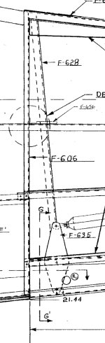

I've been in the process of a complete panel overhaul/IFR upgrade (custom etched panel, second grt horizon screen, garmin 650, etc) but I just realized my RV6A doesn't have a digital magnetometer installed (I'm not the original builder).
Since I have to have a magnetic direction indicator, is it worth it to buy the grt digital one or should I just get an old fashion wet compass? How difficult would it be to install in an already flying RV6A?
Within the last month I received all my GRT components and have since ordered the magnetometer. Im going to mount mine under the tail fairing on the deck. Jon at GRT said to run 3 /22g wires to the rear. Within the wing is another mounting option.

I really like the idea of under the tail fairing, seems a lot easier than trying to get it in the wing. What plane are you installing it in? I'd love to talk to you throughout your progress!

The magnetometer has been riding on the deck under the vertical stab fairing on my RV-6 for over 20 years. It is easy to wire and access at that location.
