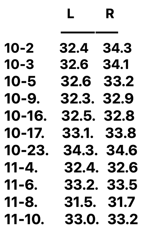

this might be a silly question.. but im younger than most of you all.. and tube tires are a completely new concept to me..
it feels like my rv12 .. and my old rv6 tires don’t hold air as good as my car tires do. is this normal? or do i have bad luck with airplane tires? or are these smaller tires more susceptible to ambient temperature changes?
I have Tire Pressure Monitors (TPM) on my main wheels and use MICHELIN AIRSTOP tubes which hold air very well. I monitor air pressure as part of my pre-flight check and notice fluctuations in pressure mainly due to ambient temperature.
It is the rubber used in the aircraft tubes that are leaking air and is normal.
There are tubes available that do NOT leak but they can be expensive.
Tell me about your tire pressure monitors. They sound interesting.
