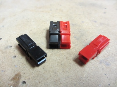

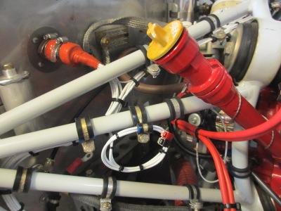

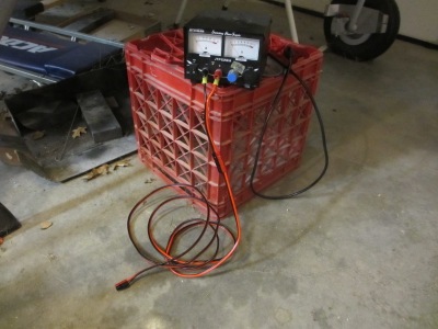

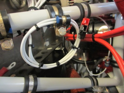

I used an Anderson Powerpole connector - available from your favorite ham radio supplier:
A lightweight adapter cable will be carried in the aircraft to allow connection to whatever DC power source happens to be available. Note that this is designed only to allow charging the battery or powering the aircraft on the ground, not for jump-starting.
I had a hard time finding the Anderson Powerpole until someone suggested a Radio Control Model shop. Bingo! They also had the crimper, heavy wire, and assembled the whole thing for me.
