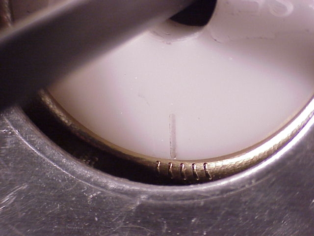

This is what the graduations for ground adjustment looks like on the RV-12 Sensenich prop. The shaft is the pitot tube. Just loosen the bolts, turn both blades (they are connected internally so they turn the same) dial a new setting, and torque the bolts. You can double check the angle with a Warp Drive (or similar) precision protractor, but I have found this set up to be very accuate side to side.
The prop that comes with the -12 kit has a restrictor plate on it so you can only turn it about 1 1/2 lines. Too much and there is not enough engine, too little and you over spin it. Pretty much right in the middle is a good balance to achieve the 5200 RPM take off minimum RPM called out by Rotax for the 912S. A very cool prop to own.
The amount of adjustment travel (Thanks Marty!) of the prop is 4 degrees. The prop seems to hit the 5200 RPM climb out requirement when you set the prop to full course, then back it off 1.6 degrees. You can double check the angle with a Warp Drive (or similar) precision protractor. This would be a great starting point anyway.

When I got mine, I called Sensenich and said there are 5 notches on my adj prop...I can only get to two...how do I get to the other three. They said, "call Vans!"

I'm pretty sure they added the restrictor plate to match the RV-12 engine, airframe, and LSA requirements. No need to exceed it unless you put a turbo on the 912, but then of course you would have a 914. ;)
I have gotten several calls from RV-12 builders with static RPM of 4600 RPM looking for advice. The setting of the ground adjustable prop should be set in the middle of the adjustment range for first engine start and run up. Static RPM is around 5,000 -5,100 per the building plans should be followed. I'm not trying to over ride the "plans" here just trying to make a post about getting the RPM where it should be for 1st flight as 4,600 RPM is too low. A good climb setting IMHO for the first 5 hours or so is a good thing if you need to do a go around, and to do your required stall work.
Don't spend too much time trying to dial in the exact RPM. The numbers will change a little as the engine breaks in and you add wheel pants, paint, etc..
