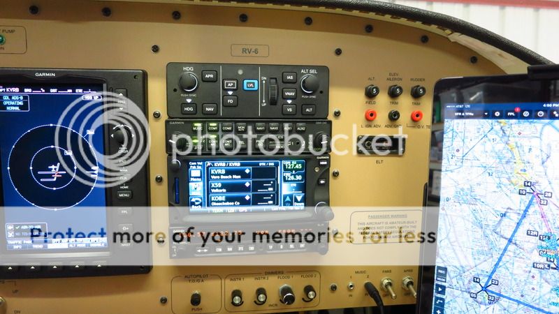

Has anyone installed GA button, if so where did you locate it.
I wanted to use the bottom blue button on the Infinity however Garmin calls for momentary DPST switch and it appears the stick buttons are SPST ??

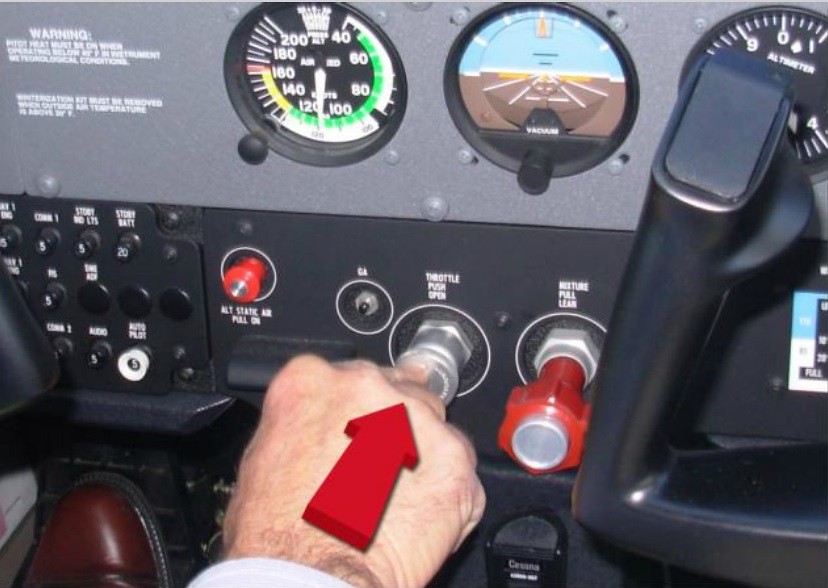

If I was installing one I'd put it near the throttle so that as you advance the throttle you can hit the button as you come up to full power.

My TOGA button is the square orange one on the right of my panel.

How I use TOGA
I have my TOGA button just to the right of my 307 panel, which very close to my Mixture control. This gives me quick easy access to it when manipulating the engine controls and 307.
I've been doing training with a guy (Matt) that flies biz jets for his day job. Even though his work planes use a different brand of avionics - functionally the G3X works just like the jets he flies.
Since training with Matt, I've start using TOGA a lot more. For Takeoff, I turn on the Flight Director by pushing the FD button on the 307 panel (AP is off). I then hit HDG on the 307 and align the heading bug to runway heading. I then dial-in my initial altitude.
After takeoff, I keep the heading bug in sync with the heading that I'm hand flying - so when I switch the AP ON, nothing crazy happens (keeps my existing heading and climbs to pre-set altitude). I usually go into VS mode at this point also with climb rate of 5-700 fpm.
During an approach, I load my Missed Approach altitude just before the FAF. When I get to the MAP, I push in the throttle and hit the TOGA button. The AP does NOT disconnent when I hit the TOGA. It starts the programmed pitch up (5 degrees for me) and flies the Missed course.
When I get to a safe altitude, I dial back the climb to 5-700 fpm. The AP then flies the full Missed procedure and stays in the Hold until I tell the AP to do something differnt.

Go Around Next to Throttle Control
I located mine next to the throttle, to be pushed as power is advanced for the G/A. G/A's are a busy enough maneuver (and not practiced much, either) that I didn't want it to be something I had to go looking for...it needed to be prominently located.
