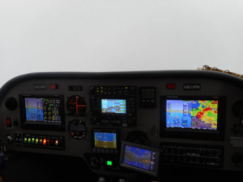

Good morning all, I have had excellent experiences with GRT. In my RV9 I had all GRT. I am told by my technological friends, that there isn’t much to choose between any of the companies as far as quality. They all use much the same bits and pieces. Where the difference lies is in the technical backup which has been both excellent and fast. They return calls promptly and for the first one spent hours with me tracing difficulties that I had, mostly self induced.....read the instructions Brent! I also had the EIS engine monitor system with that. On the other hand, while test flying my friend’s aircraft with Dynon, I had a complete screen shut down in flight which could happen to any of them, but his tech service was very slow.
I my present RV8 I have gone all GRT as far as the EFIS is concerned, but have a JPI 930 stand-alone engine monitor unit which suits me better. I would strongly recommend NOT having all engine monitor information on the EFIS. When I was faced with the dreaded black screen on the Dynon EFIS I also lost the engine information.
On my RV 8 I selected the largest screen HXr. Although it looks very good, I think I would go for the 10 inch display if I did it again. It is less expensive and I think just as good visually.
If you would like photographs of my panel contact me separately....I can’t manage to download them here.
