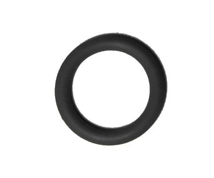

EDIT, The part # on the O-rings I am using is MS209513-006, according to Spruce they are "aviation fuel resistant". I don't know the affect ethanol has on them long term. I will source the viton equivalent. Again I have been using tone for over 500 hrs with no complaints so........

Here is the Viton equivalent:
