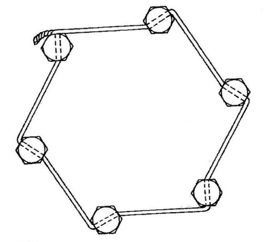

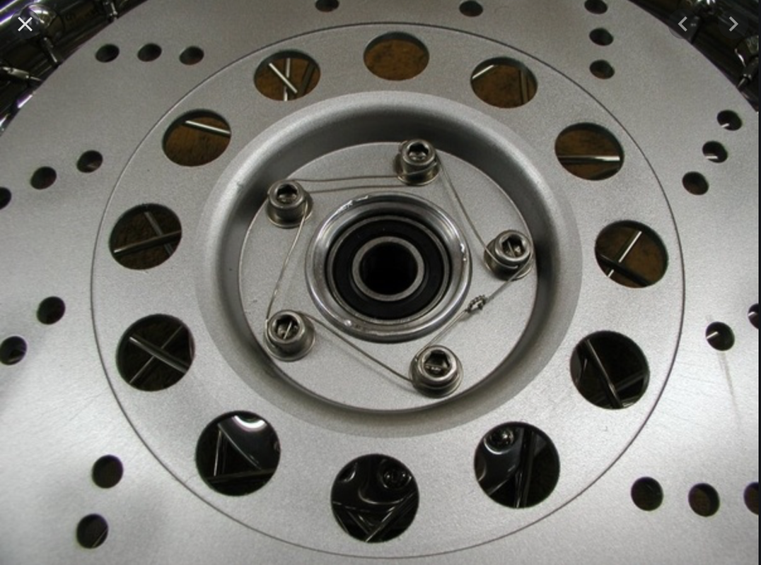

Replacing gascolator screws
During my 2nd annual I replaced all 4 gascolator screws by screws with Philipps head for better grip and secured them with appropriate Nord lock washers instead of safety wire.
The reason is that applying safety wire is a real pita in that confined space.
I am just not sure if the Nordlock washers can be considered as an alternative means of compliance in this particular application. Is that as safe as safety wire?
My plane is comparable to US EAB cert.
Thanks for your opinion on that.
Best Chris
Due to the fact that the prop hub and Matco brakes that came with my 12iS kit used Nord-Locks and no safety wire, I would say it’s an acceptable substitution.

+1 for Nord Lock washers. #10 size, 8 of them from Aircraft Spruce.
That safety wire in there was not fun to deal with... got some bleeding holes in my fingers recently. Air hose nozzle with soft rubber cone shaped tip and compressed air works well.
I did the nord lock washers with socket head cap screws. Great idea from the original thread starter. Thanks for a great idea!

Earlier discussion in this thread was in regard to safety wiring the four bolts that hold the gascolator bowl in place. It is a tough job to twist safety wire in a tightly confined area. For this application, a single strand of safety wire can be used. See below...
