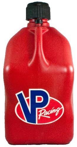

It should really be either a vented or flexible container.
Something like this would work (I have a couple) or you could pay a lot more for one of the turtlepac equivalents.
You can get vented fuel jugs from the racing guys like Summit that have handles ideally placed for securing with a seat belt. You may want to pipe the vent somewhere away from the cabin.

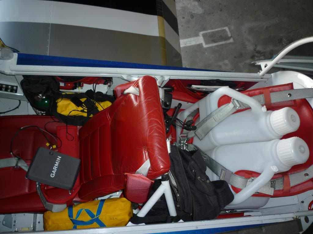

Vlad, I have a few of these you are welcome to borrow:
Nice small cap in the large cap that would allow you to fill them so that there is no air, 6 plus gallons each using that method.
Also have one cap modified with a fill tube with shutoff valve.
Thanks Mike. I have left two cans with Bruce Stamper at Cordova. I would like to borrow two more of those from you.

I used to carry 13 5gal gas cans in the back of a C180 on floats. Filled them to the full line, left the air gap, tightened all the caps, made sure no fuel would leak out, tied them down and went flying. Never smelled gas in the cockpit, no expansion or contraction problems.
I don't think that the idea was to fill to the brim. It's to fill to the normal fill line, then flex the sides of the (plastic) container inward, expelling the air and capping the container. Then the small expansion of the fuel partially returns the container to its normal shape. Very doubtful that the fuel will expand enough to fill the previous air space, especially since it's almost always cooler where you're flying than on the ground. The air tries to expand a lot with reduced air pressure at altitude; fuel not so much, right?
