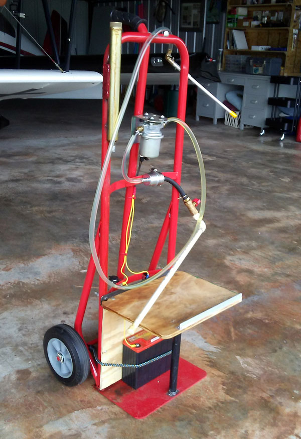

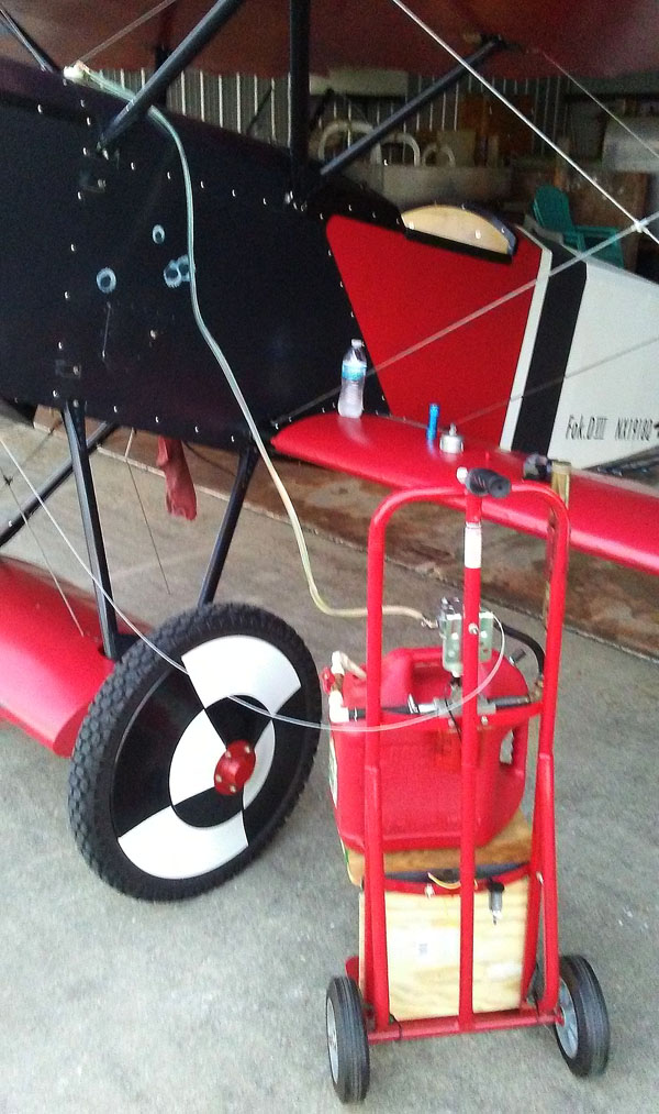

The Fokker warbird wannabe is even more awkward to fuel than the RV-12. Here is my fuel transfer rig that uses a 12vdc Carter automotive fuel pump driven with a retired PC680 battery:
This rig works great, flow rate is one gal/min. Just turn it on, step back and let it it pump. The fill nozzle is an aluminum tube which touches the fuel tank to dissipate static charge (photo shows grounding cable which is no longer used). The valve on the intake tube is closed after fueling to retain fuel in the pump so it won't have to prime next time it is used and eliminates messy drain-back.
P.S. My next-door-neighbor has an RV-12 and commandeers my fuel rig....and has retired his crank pump. :)
