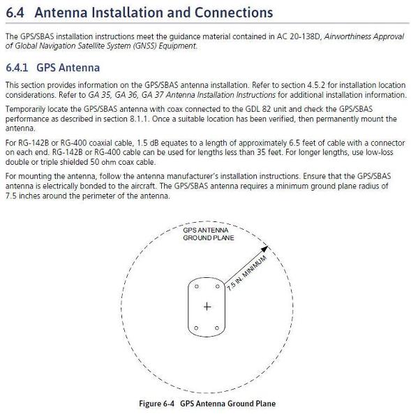

How would one do that, please? I have a question on how to install the GA-35 in a fiberglass airplane. I'm planning on installing a GDL-82 in my Lancair, but the instructions tell me I need a 20" dia ground plane under the GA-35 antenna. Certainly that can't be right because I know Lancair pilots which only have 6" dia. ground planes and those guys report no problems. My tail cone doesn't have room for a 20" ground plane so I really need to find out what the minimum diameter is.

Both the GDL and GTN ref the same 7.5" radius ground plane (not 20").
"the GPS/SBAS antenna requires a minimum ground plane radius of 7.5" inches around the perimeter of the antenna. Refer to figure 2-2. For metal aircraft, the surrounding metal skin on which the antenna is mounted supplies the ground plane. For nonmetallic aircraft, the ground plane can be composed of heavy duty aluminum foil tape, such as 3M P/N 438, 3M P/N 436, or other adhesive backed dead soft foil with aluminum 7.2 mils or greater."
I think you guys are mixing Radius and Diameter. 7.5" Radius = 15" Diameter.
Figure 6-4 in the GDL-82 installation manual shows the ground plane extending a minimum of 7.5" from the perimeter of the antenna. Since the longest dimension of the GA-35 antenna is 4.68", I took that to mean 7.5+7.5+4.68" = 19.68". I just rounded off to 20". FWIW, I know of a Lancair that only has a 6"x6" ground plane and the pilot reports that it works fine "most of the time". Upon doing some research this morning, it seems like the gain of a WAAS GPS antenna is much better with the larger ground plane. I think Garmin came up with the 7.5" number because that works out to a full wavelength at GPS frequencies. It seems like overkill to me, but WTFDIK?
Thanks, Walt. If I really need the 20" dia. ground plane, that's what I'm going to have to do. I'll apply the foil to the underside of the fuselage skin above the baggage compartment and mount the GPS antenna out in the wind. I really didn't want to mount the antenna outside the aircraft but I don't have enough room for that large of a ground plane inside. I question why a full-wave ground plane is required, though. With a comm whip antenna, only 1/4 wave is required. I think the 20" is overkill.

Here's a screen grab of the Garmin GDL-82 instructions:
So now I'm thinking of mounting the antenna on an aluminum shelf maybe 12"x12" somewhere back in there. No metal embedded in the fiberglass.
