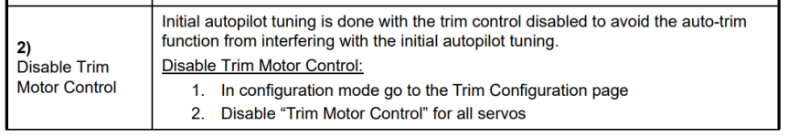

The other part that was missed was Step 2 of autopilot tuning from Appendix A: disconnect auto-trim until AP is properly tuned:

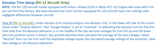

Except, it mostly doesn't cover this detail. I had that document in mind as a supplement to the PAP, I went through all of these steps a few times to be careful. With respect to trim adjustments it's pretty vague and aside from calibrating the trim indicator on the screen it mostly tells the builder to just trust Van's default. Pasted below is the entirety of trim reference in the avionics setup guide.

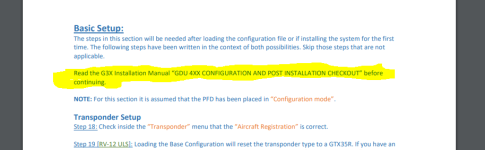

Also the readme for the G3X installations has this guidance included:
