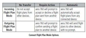

From the Aera Manual....
"NOTE: Connext features require a Bluetooth or RS-232 serial connection to
an external Connext device."
"The Connext Setup Menu can also configure how the aera 760 sends and receives
flight plans from other Connext devices. Flight plans received from other devices will
be added to the aera 760's Flight Plan List."
"• Connext 57600 Baud: Connext datalink source at 57600 baud. Used to receive ADS-B
traffic and weather data if connected to a compatible receiver.
• MapMX: Receives flight plan and navigation data from Garmin navigators. When
MapMX data is received, a more accurate depiction of the flight plan legs are displayed
on the moving map (i.e., holds, procedure turns, etc.). MapMX is the preferred data
source when interfacing with Garmin navigators."

I think the main question in the thread after reading the various manuals is if the 760 is connected to an external Garmin device/navigator via RS232 with MapMx and external source is selected on the 760 (per your picture), can you build or update the flight plan on the 760 (like switching approach transition from vectors to a specific IAP) and have it transferred to the external navigator either manually or automatically. The 760 pilots guide manual page 83 suggests 2 way transfer but mentions connext and bluetooth not MapMx and RS232.
In the install manual page 197 it states that MapMx is preferred when interfacing with Garmin navigators.
With 2 connection choices (RS232 and BT), and connext and MapMx, what is the correct configuration to get 2 way flight plan transfer, ADSB weather and traffic, AHARS etc.

Hi Nick and Figs,
There is currently no support for bi-directional flight plan sharing between a Garmin IFR navigator and the Aera 660/760 using RS-232.
You can, of course, select External flight planning on the Aera 660/760 and use the preferred method of configuring one of the two Aera 660/760 RS-232 ports for MapMX and continuously receive full flight plan and curved path guidance (including holds, procedure turns, and missed approach guidance) directly from the Garmin IFR navigator.
AL9nZEVne_FVtKuCl3cl5hnIOfCaF_92cPQO-CiTKsRNdCW9lYh4Qxo9aRLMXnH1OPwYu14_Gd_XjFUs9Cla0jjoQVA-1Bod2UFeAA_aeEjZAPDY27LBY4RtAr3hSy5Fr74e68G13ljXErubKogwHXfF27f_=w380
If you want to share flight plans bi-directionally between the Aera 660/760 and a Bluetooth equipped Garmin IFR navigator, you would need to use a Connext Bluetooth link. For example, for my Aera 760 and GNX 375, I can establish a Bluetooth connection between the two and bi-directionally share flight plan changes when using Internal flight planning on the Aera 760.
I have flown with an Aera 660/760 hardwired with RS-232 to a GNX 375 for several years, and what works best for me is to leave the Aera 760 in internal flight planning and have the GNX 375 always synchronize its flight plan and approach guidance with the Aera 760 over MapMX RS-232.
When using Internal flight planning on the G3X Touch system, the GDU 4XX PFD keeps the GNX 375 synchronized with the current flight plan, which then shares this data with the Aera 760 over MapMX.
I always keep the 2nd RS-232 port on the Aera 760 configured for Connext 57600 and connected to a Garmin ADS-B traffic/weather receiver. In my plane, I have both a GDL 52R (SXM Weather/Music and ADS-B Traffic/Weather) and the GNX 375 (ADS-B traffic/weather). Since the GDL 52R is the worlds best and most capable music/traffic/weather receiver, that is what I connect to the Aera 760. I can also control the GDL 52R SXM music selection from the Aera 760.
Both the GDL 52R and GNX 375 also provide a Bluetooth connection for traffic/weather which I sometimes use for a second Aera in the back seat for a passenger.

2. Have you tried configuring a "wired Connext connection" for flightplan sharing per the manual and the Garmin sales video or is that not even an option in the port configuration list and you are stuck with MapMX?
"Connext features require a Bluetooth or RS-232 serial connection to
an external Connext device...The Connext Setup Menu can also configure how the aera 760 sends and receives
https://www.youtube.com/watch?v=l_21TRfHLHg&t=153s
3. If you use a bluetooth Connext connection to either the G3X or the GTN (via Flightstream 510), will the flightplans be synchronized on all three devices.
4. Have you tried an RS-232 connection in any flavor to the G3X rather than to a GTN/GTX?
5. Can you have a both a hardwired and bluetooth connection for flightplans (from your description it sounds like yes)
6. Do the Bluetooth Connext flight plans support curved flight paths like the MapMX does?

Not sure I understand the question. As you say, pages 196 and 197 of the current Rev. D Aera 760 manual explain the available RS-232 configuration options. If you have a specific question on any of these, let me know.
It has been a couple of years, but yes I used a wired Connext 57600 interface from the Aera 660/760 to the GNX 375 and could not share flight plans over this link. I believe that Justin mentioned in an earlier posting that Garmin is looking into this.
I don't consider that I am "stuck with using MapMX" and will continue to use MapMX regardless of what comes in the future because I don't want to use the Aera 660/760 in Internal flight planning mode except as a backup navigator.
Sorry, but I don't use Bluetooth to either the GDU or GNX for flight plan sharing in my plane, so I am not the best source of information on this. I don't like to recommend anything that I don't use. I do all flight plan editing directly on the GNX or GDU, and it always works great!
As explained above, there is currently no hardwire support for sharing flight plans with an Aera 660/760.
Yes and No. When you load an approach on the Aera 760, it will show any procedure turn and missed approach holding pattern (like shown on a chart), but nothing except for MapMX provides the dynamically changing real-time curved path navigation data being provided by the IFR navigator to the pilot and autopilot.
Steve

To clarify question #1 I was hoping you could list what actually appears on the device for options for the RS-232.
The manual on page 196 and 197 is inconsistent (for example Connext isn't shown in the list but is mentioned in the text)
To clarify question #5
If I have mapmx connected to the Aera via RS-232 can I chose to use the Connext Bluetooth connection instead or does having the RS-232 connected disable the Bluetooth Connext connection for flightplans.
Thanks Steve
What is displayed on the device matches what is in the manual except that there are 2 NMEA Out options (NMEA Out 4800 baud and NMEA Out 9600 baud)
Not correct. It says this at the top of page 197 which makes it clear that Connext 57600 RS-232 is only used for traffic/weather (not flight plan sharing).
Connext 57600 Baud: Connext datalink source at 57600 baud. Used to receive ADS-B traffic and weather data if connected to a compatible receiver.
There is no problem with having the MapMX RS-232 connected to the Aera 760 and using Internal flight planning with Connext Bluetooth, which disables the use of MapMX (until External flight planning is chosen again).

Hi Nick and Figs,
With the way I operate the Aera 760, it is basically a super capable MFD that is always synchronized (over MapMX) with whatever is being used to navigate and drive the G3X Touch autopilot.
Let me know if I failed to answer any of your questions.
Steve
