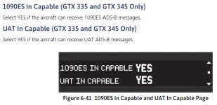

Garmin may have already told you to check this, but the first thing to check is that your GTX 335 is properly setup to tell the ground stations that your aircraft ADS-B dual frequency receiver is receiving traffic targets on both 1090 Mhz and 978 Mhz. This is how you do this on the GTX 335.
The 335 is set up as you showed. Both 1090ES and UAT input capabilities are being reported.
