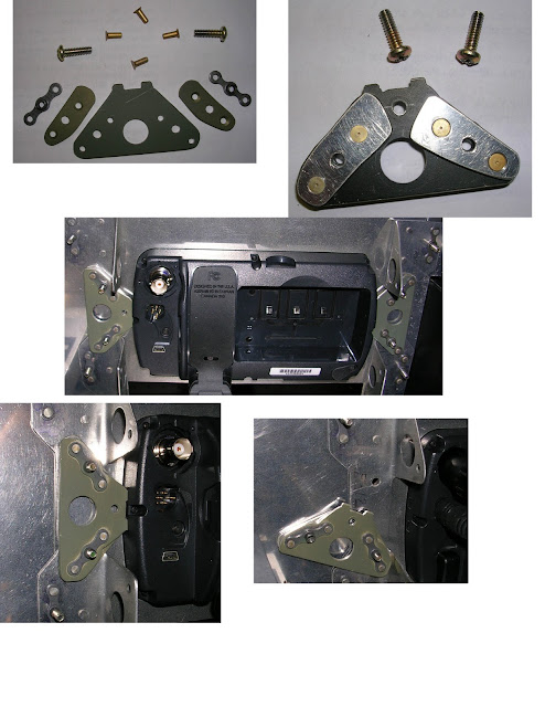

GPS retainers
I can remove the GPS and NO modification to the panel was necessary.
The instrument panel opening does not have to be enlarged to insert or remove the GPS.
The GPS retainers only weigh 0.8 oz.
The GPS can be removed by taking out one screw from each side and by loosening the other screws slightly. Then turning the slightly loosened screws a few degrees will rotate the GPS Retainer, thus unlocking the GPS. Top cover does not have to be removed. No modification to the airframe is required. The GPS Retainers hold the GPS securely without any play.
It takes a little filing to get the ears on the GPS Retainers to clear the GPS slots while rotating the GPS Retainers.
I made the GPS Retainers out of 0.063 scrap. The spacers on the right side are 0.063. The spacers on the left do not need to be as thick.
