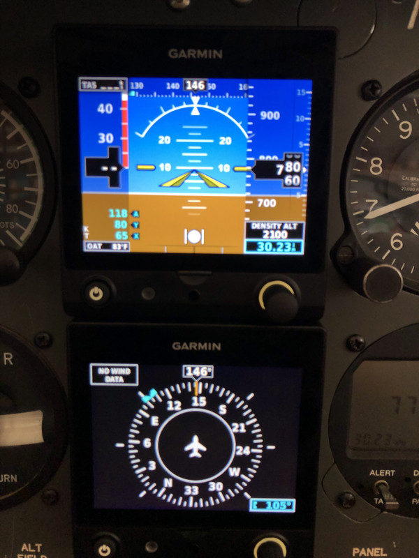

I got the GAD 13 with 'homemade' OAT prop installed and powered up today for the first time.
My 'homemade' OAT prop (same as used my Rocky Mountain Instrument microEncoder and microMonitor) is working. Initial OAT read 1 degree F higher than my digital thermometer in my hangar. Note TAS upper left hand corner, OAT lower left hand corner, and density altitude lower right hand corner of the upper G5 and on the lower G5 "No Wind Data" in the upper left hand corner.
Now I need to pick stuff up, finish paperwork, and go test fly.

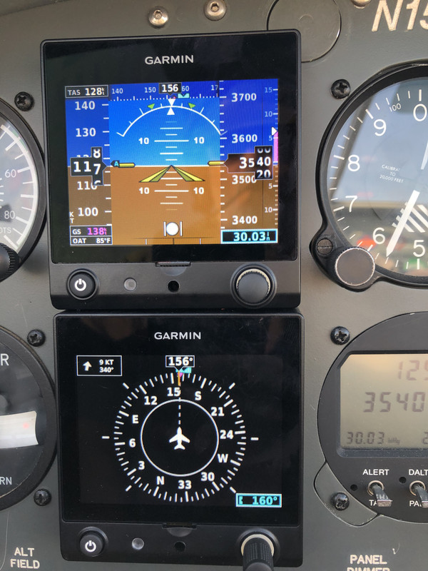

G5 with GAD 13 in fight photo
I finally flew my new GAD 13 today. Garmin equipment installed are two G5s, GMU 11, and GAD 13. I am using a homemade OAT probe using the instructions from RMI microEncoder assembly manual. (page 49 has assembly instructions) Everything worked inflight just like I expected. The surprise I had was when I was on downwind at pattern altitude (1,000 AGL) I had 18 Kts crosswind almost 90 degrees to the runway. I could see the windsock on the ground indicating calm winds.
When on the ground, Density Altitude is displayed above the altimeter setting but it disappears when flying.

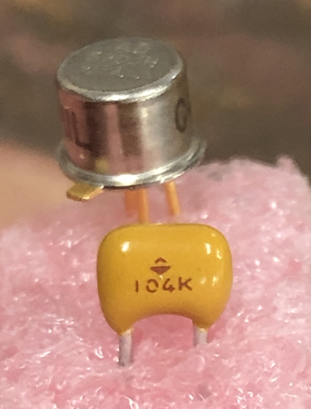

The copy of the RMI instructions that I pulled offline (Rev D, 1/1/04) specifies a ".1FFD" ceramic cap with the first F looking like it has been changed (different font).
Is that supposed to be picofarad or microfarad? I am not familar with FFD.
Gary,
Thanks for your excellent write-up of this little money-saver.
0.1 micro Farad is the value recorded in my PAPER copy dated Rev B, 12/30/1994. Sometimes the electronic PDF copies does not handle the special characters correctly.
Here is the image of a capacitor like the one that I used.
Here is the image of the temperature transducer like the one I used.

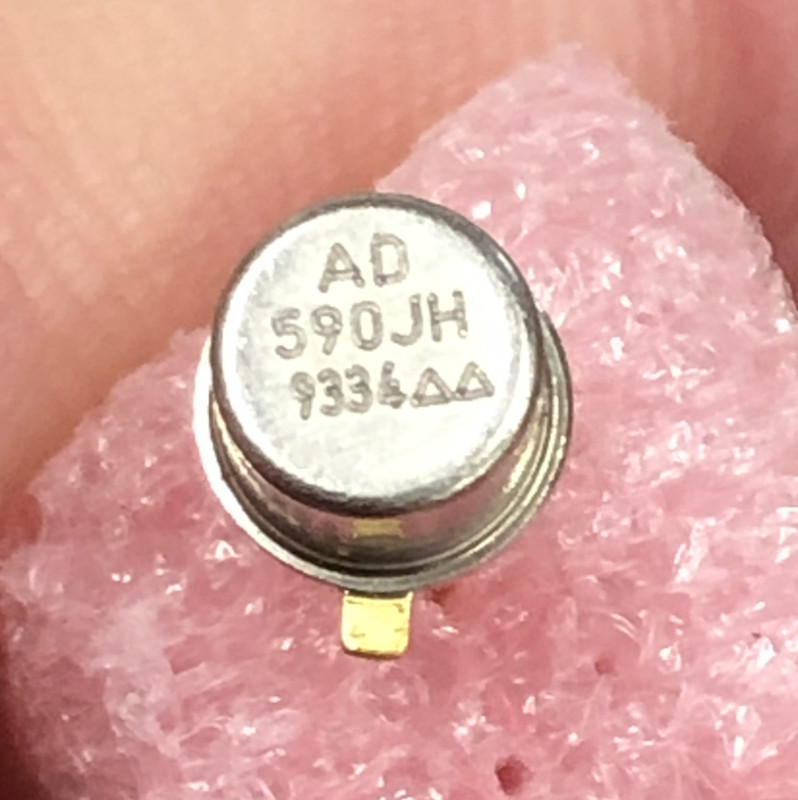

My entry into this Inexpensive Temp Probe Derby is based on a thin film platinum device from, you guessed it, Digikey. Suprisingly, they are cheap, accurate, but also very tiny.
I thought some of you might be interested in another way to git'r done.
What I have now is basically a GTP 59 probe clone.
I bought a bunch of TE pn 223-1820's which are 1kohm units. To get the required 500 ohms for the GAD 13, I put 2 in parallel to make what is effectively a single 500 ohm device. One connection goes to GAD13 pin 6. The other side of the device goes to pin 3 AND 8 with a jumper.
If you are all about precision( i am), or have a long run or are using thin wire, consider using 3 wires. In this case, run 2 separate wires from one side of the device to pins 3 and 8 of the GAD 13 - no jumper. This is the way the GTP 59 is installed. It only makes a very small difference. Spruce's 24 gauge x 3 shielded cable or similar might be a good choice for probe cable.
Tested accuracy was pretty good. Distilled water ice temp was spot on 32F. Boiling water temp was ~207.9F. The calculated temp for my pressure altitude was 209.33F. So, off by ~1.5F, quite good. Less than 1 degree C. This will correspond to a small fraction of a degree at flight air temps. Testing was done using 2 short wires and jumper.

Hi Peter
The sensors I used have leads, so the mounting would be similar to using the AD590- .
The easiest mounting for most applications would be to solder the device to the cable wires and then install it in a small piece of tubing, maybe brass tubing as the OP described.
In my case, the sensor location will be a well ventilated wheel well and mounting will be by simply cable clamping in place.
BTW, The specs for these RTD devices are generally much better than the cheapo grade AD590 ($20). I bought 25 for of these RTD's for ~$40.
Also, this approach may be a satisfactory sub for the GTP 59 to use with the G3X. Someone should look into that, since, in that case, there is no alternate probe source for the GPT 59 $$$.

Density altitude..
I wonder if Garmin don't want density altitude to be displayed when airborne as it could then be confused with real altitude...which is a shame as knowing the density altitude can be really helpful at times...

"No Wind Data"
Any ideas why this happens/displays? I have GAD 13 feeding into G5 and getting OAT and TAS, but no wind speed and direction.
Thx!

"No Wind Data"
Thx!
In the picture above, the aircraft is parked on the ground. When stationary, GPS TRK and GPS Ground Speed are invalid, and the system cannot calculate winds aloft.
You also need a GMU 11 since heading is also required to calculate winds aloft.
Steve
