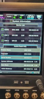

Several system LRU's will be updated with this software load, the software download page includes a detailed LRU software change list. Cross-referencing the System Information page in configuration mode, please ensure each LRU is successfully updated to the appropriate software level upon completion of the software load.
