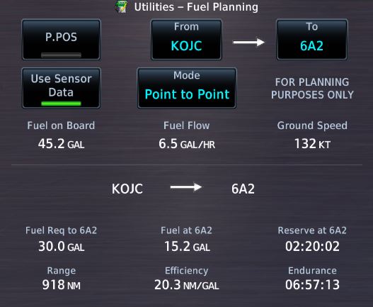

  • One of the most frequently requested updates we have received is to allow fuel flow information to be sent from the G3X Touch to an adjacent GTN (Xi) Series Navigator. This G3X Touch software update will make that data transfer possible. Updated GTN (V6.71+) or GTN Xi (V20.12+) software is required for this to work. The GTN Software update can be found using the same link provided above for the G3X Touch software. Once the GTN is updated, change the ARINC input on the GTN (that is receiving data from the GAD 29) from EFIS FORMAT 2 to GDU FORMAT 2. You will then be able to select Use Sensor Data on the GTN (Xi) Fuel Planning page. No configuration change is required on the G3X Touch side. Fuel Remaining is also sent to the Navigator using this datapath.

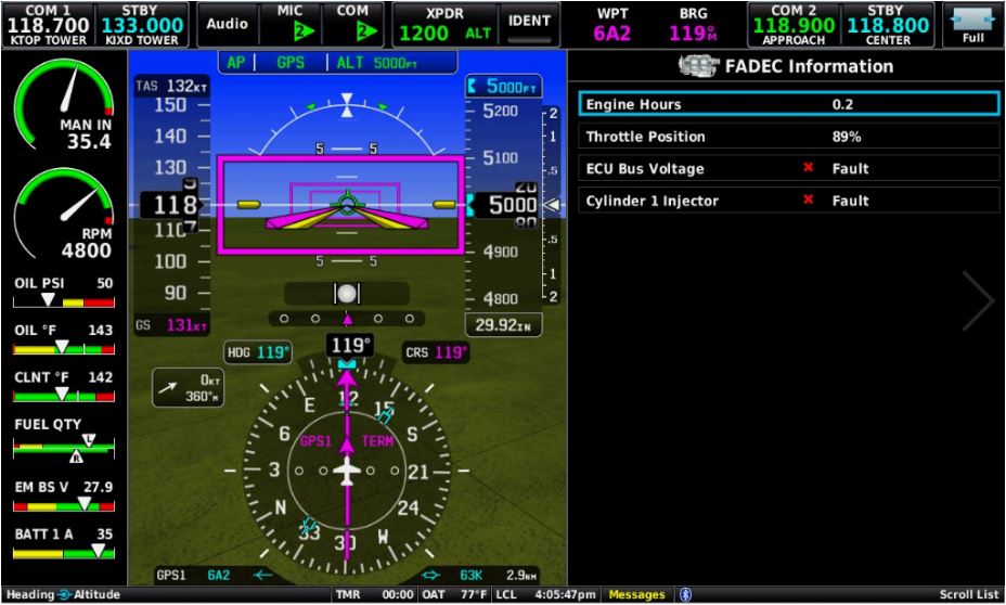

  • Display of Rotax FADEC information in normal mode. This can be accessed from the ENG menu, by pressing the MENU button and selecting FADEC Information. Alternatively, press MENU twice, select Setup, Engine, and then FADEC to view this information.

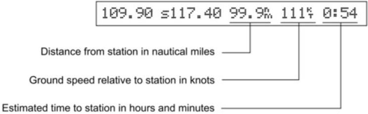

  • Provide DST data on GARMIN VHF NAV output, to an SL 30 NAV/COM. To enable display of this information on the SL-30, Press SEL while in NAV mode. Turn the large knob to the DST datalist. Press ENT to enable the display of DST data.

Justin, please clarify...
...allow fuel flow information to be sent from the G3X Touch to an adjacent GTN (Xi) Series Navigator.
Can fuel flow info be sent only to Xi navigators or to GTN750 non Xi navigators as well?
Fuel Flow Transfer
This works for both the GTN and GTN Xi Series Navigators.
Justin

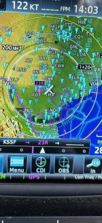

I have a GDL 50R providing traffic and WX to my two G3x Touch units via Bluetooth on one and hardwired to the second. Does this new release support all the WX functions via the hard wire or is it still necessary to use the BT connect for that data?
Good Morning,
Here is a quick update on the addition of the newer FIS-B products to the RS-232 datapath. The GTX X45(R) software required for this to work was released in March of this year. We have the required GDU updates planned to be included in the next G3X Touch software update, later this summer. The required GDL 5X software update is planned to be released later this year.
Justin

I changed my GTN to GDU Format 2 today and noticed that the Fuel Range and Fuel reserve ring showed up. I also now have a white ring that shows up with hatched marking around the edge. Does anyone know what this is?
TIA!
This is a picture showing the ring with the perpendicular lines on the inner part of it. It's not a range ring as that is show here also.
