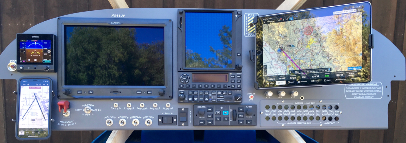

I decided to pay the premuim for the 750, and I?m glad I did. It is mounted in a center stack moved about 5? to the left of normal(for RV 7/9) so is very pilot centric, and the larger screen serves as a ?supplemental MFD? for the single 10?G3X Touch straight ahead. Overall cost about the same as a GTN650 with two G3X 10 inch screens, but lighter and more compact, leaving room for an iPad 11? pro on a ram mount on the right side. - Otis
