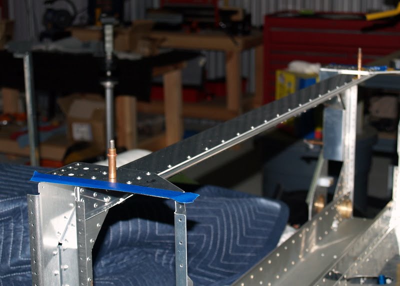

Page 23-02 Step 3: I used a 3/4" steel water-pipe coupling inside of the angle and squeezed it with a vise. It will be too hard to turn the vise handle if you use anything longer than a coupling. Check the angle with a square and there should be about 1/16 of inch gap at the vertex. The object of twisting is to have the top of the longeron flat and on the same plane for the entire length. You can read how others did this step here: http://www.vansairforce.com/community/showthread.php?t=39010&highlight=longerons
Page 23-02 Step 4: Figure 1 shows the hammer away from the vise, but the longeron should be struck right next to the vise. When bending the aft end of the longeron, I calculated that the end needs to be bent inward slightly less than 7/16", 27/64" to be exact.

Page 23-08 Step 1: Cut the hinge 10.5" long. After studying each half, cut another 1/2" off to make it match the picture.
Page 24-02 Step 1: There is no top or bottom or left or right to the F-1231 B&C Roll bar Straps. Bend them in the same direction of their natural curve. Just make sure that the angles at the ends of the straps match the channels. It is the forward and aft edges that must be orientated correctly.
Page 24-02 Step 3: De-burr all holes.
Page 24-02 Step 4: Some builders had trouble with the width of the roll bar not matching the spacing of the roll bar bases. Make sure the ends are the correct distance apart as you rivet. Read what other said about this at http://www.vansairforce.com/community/showthread.php?t=39763&highlight=roll+bar
Page 24-03 Step 1: Leave the bolts in the F-1231D Roll Bar Bases loose until you slide the roll bar over the bases. You can final tighten the bolts with a swivel-head wrench such as the Proto 1270-14. See http://www.grainger.com/Grainger/items/1Q284
Page 24-03 Step 4: If you have trouble removing the roll bar, a 2x2 from a crate, inserted into the lightening hole, makes a good pry lever. Set another block of wood under it for a fulcrum.
