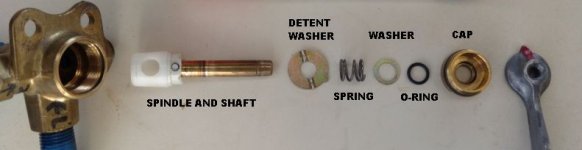

My Vans fuel valve is seeping slightly just below the handle. Anyone bothered to rebuild one? Assume it’s a matter of replacing O rings or seals….? Don’t suppose Vans has a kit….

Just unscrew the cap and replace the two o-rings.
Very easy valve to replace those two O-rings. You don’t even have to remove the valve from the plane either, just drain both tanks, remove the handle, and unthread the top cap. Do NOT use fuel lube on the valve unless you are sure you don’t go anywhere cold.. I had mine nearly impossible to turn after cold soaking up at 17,500 feet. I plan to wash it out and maybe try Kryox grease that I bought. Also be careful not to damage the gasket under the cap..

What are the o-ring numbers?
Isn't that the basic question? You can get from Spruce using mil spec o-rings. No kits - liability.
777Dave - there are only two o-rings, EDPM will be fine, 1/16" cross section. The large one is .750" ID 1/16" cross section - 018 number. Nitrile
the small one is .312" ID, and either 1/16" or 3/32" cross section -011 or -109 number. Nitrile
I don't remember what the small o-ring cross section was, but you can measure your valve get both to be sure. 70% it is 1/16"
Clean and lube with Krytox. I just rebuilt one and still on the bench, if you really need the small I will take it apart and measure for you.
Here is the o-ring chart so you can measure and verify yours. This is a super handy chart. Use ID of your application and select closest section.
View attachment O-ring_Size_Chart.pdf

my fuel valve orings started leaking at about 20 years in my rv .
simple fix and very reliable valve.

If that ever happens again, you can free the cone by lifting the handle with two fingers under the handle and then turn it.
Excellent tip.
Mine just started to get hard to turn. I have been reading this thread hoping for how to lubricant and behold this helpful tip of just lifting on the handle. Worked great, turns like it used to, easy and smooth.
