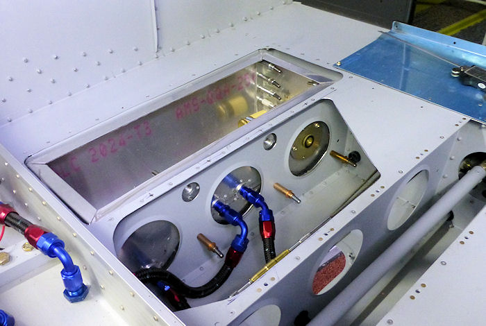

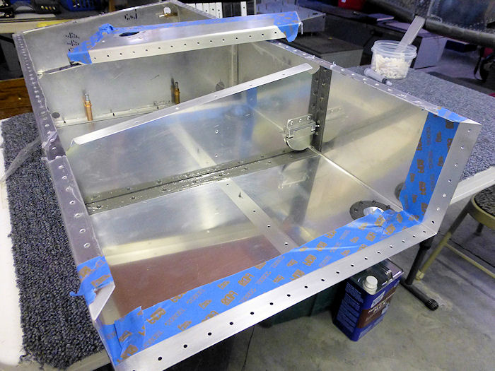

My tanks are homemade.
Wing Tank
Header Tank
http://joesrv12.com/Builder Log/al_06_05.htm
