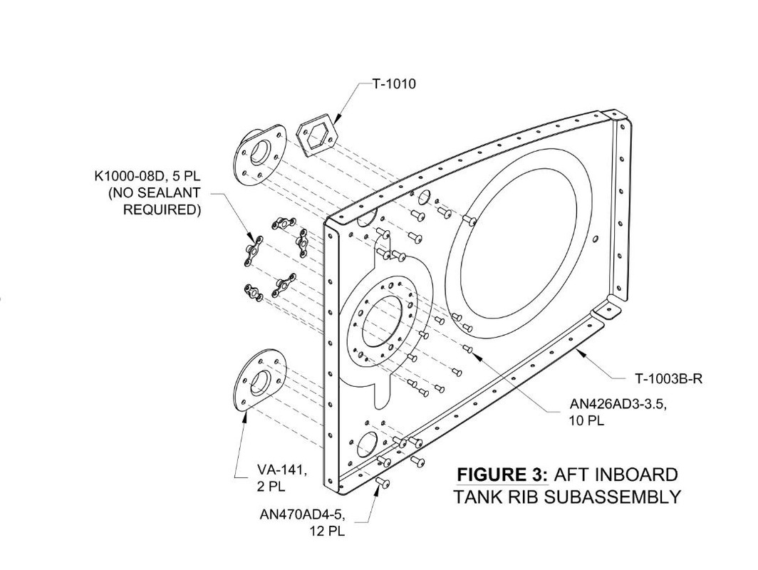

There's a big ol' access plate that goes on the inboard side of the fuel tank, covering a big ol' hole that you cut in the rib. Our question, dumb as it may be...why? Do you really *need* to cut that sucker out, or could one just mount the fuel pickup to the rib? When would you ever need to get into the tank, anyway? You can't repair a leak other than on the inboard bay via that access. To repair or replace the fuel pickup, perhaps? How often would one need to do that?
Or is there some other reason for this access hole that we're missing?

I elected capacitive gages and I custom designed a conventional fuel inlet in the bottom rear corner of the tank to accept an externally removable finger screen. This was before the fuel fitting SB and before seeing the RV-10 tank which is basically the same idea. With no moving parts inside, I deleted the access panel. It is not needed for tank assembly.
I would have left the panel in place in any other tank configuration (ie: std pickup, flop tube, float gages)
If I run into trouble, I have saved the panel parts and will install in the back baffle adjacent to the problem needing to be fixed.
I think it is there to make it easier to service the fuel pickup and and sender unit should there ever be a problem. Without it, you will have to cut into the plate, and that is a lot harder to do after the tank is built. The cork gasket is there to make gaining access easier though, if you prosealed both sides, it will still be a pain (it will be a super pain if you didn't use the gasket). The only thing I would do differently over what the plans say is to add an extra fitting for a possible, future fuel return line needed by some fuel injection systems.
Many of us have used proseal and NO gasket on the access plate. No leaks and it's not all that difficult to remove when needed.

And lastly...if I had to repair or replace the flop tube or fuel pickup, couldn't I just cut the access hole at that time and retrofit it if/when it ever needed to be done? How often does a fuel pickup "go bad" or need servicing, anyway? I haven't any idea, just asking.
More and more I'm thinking screw the access panel...just another messy job w/ sealant and a potential leak and a bunch of work for not much, if any, gain...unless I'm missing something really critical here...
Its possible to remove the plans-built access plate even with the wings attached. I dont think you could cut an access plate after the fact with the wings attached however.

The one thought I had was that the access plate allows you to put your fuel pickup tube(s) in after sealing all the ribs and the rear baffle, thus avoiding the possibility of somehow getting sealant on the pickup end of the tube during assembly. I suppose that might be a very good reason to have an access plate...
Newer model design would allow this.

I realize this is an old thread. That said, now you could set up your float style gauge as is done on the RV-10 & 14. No access cover installed.
