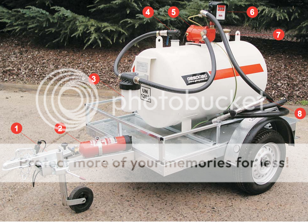

100 gallon capacity, 12v pump and battery, dual filters, and a metering gage so I can charge my buddies what they buy.
CDL Required
Anything over 117 or 119 gallons (can't remember which I think) requires a CDL (commercial drivers license) with hazmat endorsement.

Are there any legal considerations to transporting that much gas on a trailer?
--Bill
Not that I am aware of, I think Steve has it right and it's a 100 gallon tank. I've been using it for 9 years now and pumped over 5,000 gallons through it.
You shouldn't have any problem there...it looks agricultural...get some more manure on the tires. And why is there no big N on it? I thought the Huskers were supposed to be explosive...lol.

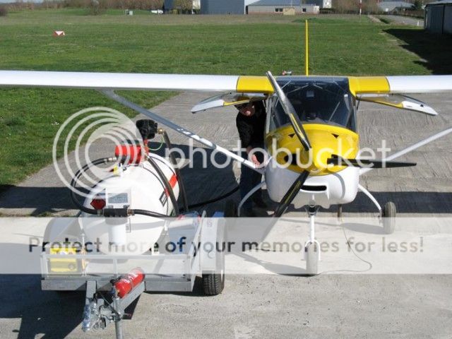

from Spain
Yesterday saw some neat fuel stations on the Web. Made in Spain. Larry you should check on patent enfringement :D
