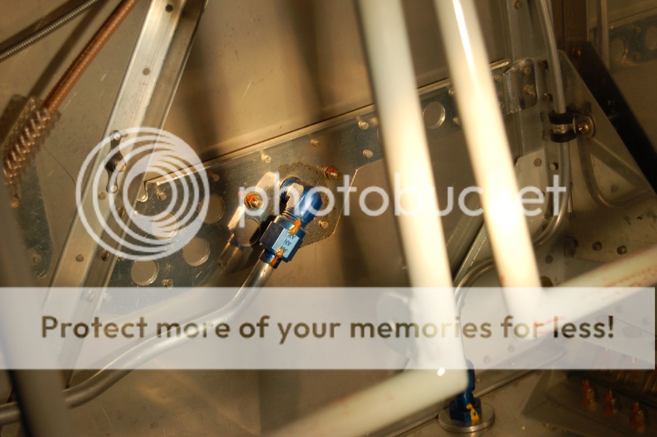

I had a fuel smell that was very faint but bugged me. I discovered it when I checked the vent lines. There was some blue residue that collected at the bottom of an AN bulkhead elbow which revealed the source. Another 1/8 turn fixed it. It was the right side 90 degree bulkhead fitting (see picture):

Ok thanks Walt and vlad. It's only when I flip low pressure boost om. I'm think it has to be from pump to gascolator. I'll keep looking
The fuel evaporates but the blue dye does not. Rub your fingers around each of the connections - any residual dye will stain your fingers at a leakage point. The leak may be obscured from view even with inspection mirrors.

Well, after a littLe vigilence and contorting my big body in under the panel, I uncovered all my fuel lines and finally found my fuel leak. Thanks for all the tips! As it turns out, the culprit was exactly what Vlad had posted for me. It was the 90' AN fitting that goes through the firewall and doubler into the gascolator! The fitting was not completely tight and it could have used a bit more sealant. I replaced it and since I was able to tighten it another quarter turn, I had to remanufacture a new fuel line from the boost pump to the gadcolators elbow fitting. The fuel did not leak to sighting for about fifteen full seconds of running the boost pump so it was a slow leak. And, since it was behind the doubler, it took it a while to show itself. I'm very glad to have stuck with it and finding it. Thanks to you all for taking the time to give advice and pics! Back in the air for N771MK!
