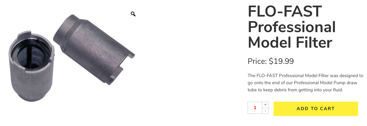

FLO-FAST offers a 80 micron cartridge filter that mounts on the bottom of the pump pickup tube.
Question - How do you fill the 7.5 FLO-FAST container? Do not use the pump in reverse otherwise you will contaminate the clean side of the filter.

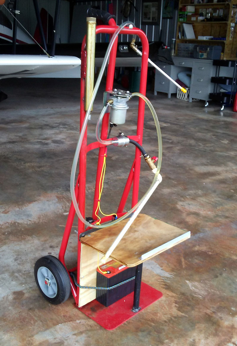

Here is the fuel transfer station I built for my Fokker biplane. My RV-12 hangar neighbor likes it so much he furnished a replacement battery for it.
It uses a Carter automotive fuel pump and an automotive filter. It pumps at ~1 gal/min and is powered by a retired PC-680. The aluminum nozzles grounds against the aircraft fuel tank. A 5-gal plastic can sits on the shelf and the ball valve prevents back flow when the can is removed. A power receptacle makes it easy to hook up a charger every ten can-loads or so.
I really like the fuel transfer station you made. While I like the Flo-Fast, I think it is expensive. I think I could build one like yours for quite a bit less and have a usable cart.
My one question is about the 5 gallon can being grounded. Experts always say that the 5 gallon can should be on the ground when being filled at the gas station. Does the 5 gallon can need to be grounded when it is sitting on the plywood shelf on your cart?
I use plastic 5 gallon gas cans. I only put 4 gallons in each one because I am 72 and 5 gallons is easier to lift than 5. So a pumping solution would be good. I just wonder it the can needs to be grounded?

It looks like your filter is before the pump, I put mine after the pump so if ever anything broke free from the pump the filter should catch it. I really love my pumping system. I have two 14 gal plastic cans with quick connects on the bottom along with shutoff valves. These cans are probably made for fueling up boats. I removed the fuel dispensing line that came with the cans and just screw in my suction line. Open the ball valve I installed on my suction line then open the valve on the can and pump fuel. When done, I lay the can down , close my suction valve. Wait a couple seconds and undo the connection. The little fuel in the connector flows back into the can and then close the valve on the can. Replace the dirt caps and I'm done. No mess and no hassle. love it.
