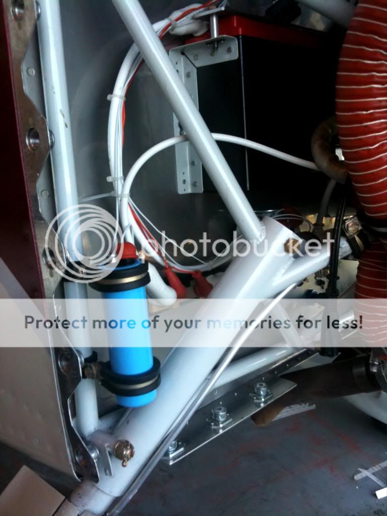

Tony
Here's a photo of how I mounted my cap. It's (+) goes to battery positive, (-) goes to battery ground. The capacitor does a great job of removing alternator whine and strobe light noise. Probably fuel pump noise as well - I simply don't hear any electrical noise in my headset.

Just a comment from an electrical standpoint, filter capacitors should be placed as close as possible to the noise source with the leads kept as short as possible.
The battery is already a great "capacitor" itself, so placing another capacitor across it's terminals would likely have negligable or no effect at all on noise generated by the pump, alternator or any other device.
Also, caps don't really do well in heat so the FWF location shown is not ideal.
Heat and Location
(First of all, I apologize for posting a pic of an RV-7 installation in an RV-12 thread. RV-12s have to be built per the manual!)
Walt,
You make good points about the FWF heat, and putting the cap as close (electrically) as possible to the noise source.
As for the FWF heat, I can't argue about the temperature - I don't know how hot that area of the engine compartment is getting - but the cap has been flown in OAT up to about 100F, altitudes up to 17,750', and looks as good as new.
As for the electrical noise, when I installed the cap, I simply wanted to provide a "sink" for any stray noise in the system. The wiring runs are all relatively short - maybe 10' of wire max from the battery/alternator to each of the loads, so the cap is (electrically) very close to each of the noisy loads. Since I don't experience any noise, I haven't felt the need to relocate the cap.
FWIW - noisy loads are going to be the Strobe power supply, the Alternator, the Fuel Pump, Trim Servos and Autopilot Servos, and Magneto P-Leads.
