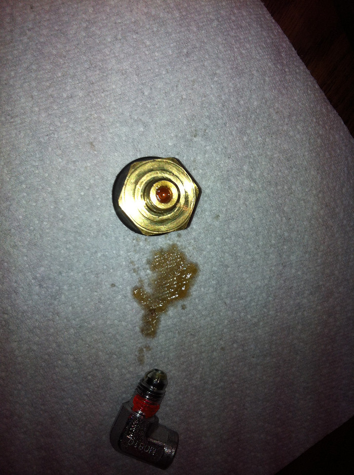

Next I pulled off the fitting at the fuel pressure sensor and an orange-ish colored gel came out.
I removed the fuel pressure sensor completely and cleaned it out. Here is a picture I took with my iPhone that shows some of this gel like substance in the pressure sensor.
Now the events from last Tuesday make more sense. It was an early morning flight. The plane had been sitting in the cold hangar which most likely caused this gel to harden to the point where the electric fuel pump would not allow the sensor to see the pressure. Once the plane started, the additional pressure from the mechanical fuel pump pushed the gel to the sensor. Then after shutting down the gel had been moved or dissolved enough to see the pressure from the electric pump only.
It has been warmer (in the 50's) the past few days which is most likely why we could not replicate it.
Now the question is where did this gel come from and will it come back?

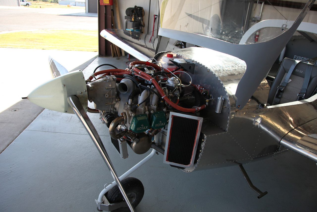

There is flow in every other line except this one. The line goes from the top of the manifold and slopes down the fuel pressure sensor.
Here is a picture of it. You can see the fuel pressure sensor on the firewall/pilot side.
I wonder if it was moved up higher than the manifold if it would drain each time?
