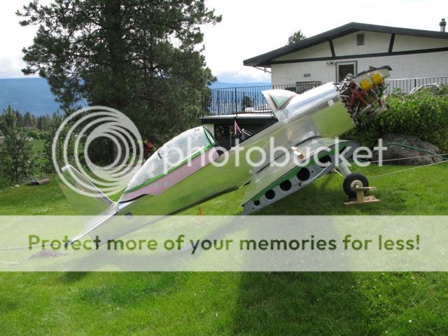

Been reading Firewall Forward and AC 90-89, planning things to do as I finish up. Does anyone (RV builders) dig a pit for the tail, and/or block up their plane to "takeoff " attitude to measure boost pump flow?
I would think that you would get a good equivalent measure if you just added a length of tube or hose to make the pump push fuel up a few feet after the fitting you disconnected from the fuel servo or carb. Just make sure not to run a closed hose back down from the high point to eliminate any siphon assist.
No ditches nearby to put the tail in?
With a cookie cutter plane like an RV, you're probably pretty safe (but not necessarily legal) as long as the fuel flows at all. But the goal of the test is to check the whole system. With some planes, unusual attitudes can do things like unport the fuel pickups, or get the carb higher than the sump (with no fuel pump). Just extending the FWF part of the system upward a bit won't test the system in the rest of the airframe.
The tail down attitude of the 7 yields better (less fuel remaining) performance, as does the 10. It is more that there are no suction leaks with the additional head from the tank to the fuel pump that would be tested. If you air pressure tested the system from wing root to servo, then you can be assured that section is good.
Then test at level and as much nose down as you are comfortable with. Tail down attitude for tail dragger is 12 degrees. Nose down for landing, I was able to get about 8 degrees with a weight on the tail and good blocks under the mains. I don't think a pit is necessary. For an A model sitting the mains on extra blocks, maybe 4" then nose down on the flat should give you an idea of the change. Not as much as you might think.
I pushed the suction screen as low in the tank as it would go (7) and took a picture with a camera internally. If it is sitting on top of the drain, you are good there and should have good readings. Not sure what model you are testing.
Be sure to run the fuel pump at 30 psi and 16 GPM for the test (IO360M1B), or max fuel flow at desired pressure for your configuration. It takes about 150 grams of fuel to fill the system, so the first side to be measured will read higher (fuel remaining) than the second. Yes, I used one gallon for the test, and measured by using a scale. PM me if you have questions. I used a clear section just before the back pressure valve to observe possible bubbles in the flow indicating cavitation somewhere in the system. There should be none.
Since sloshing and slip is not included, you will find for real life usage the fuel remaining test result will yield an uncomfortably low number.
