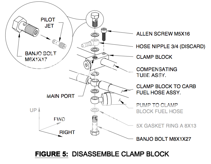

We did our first ground runs yesterday and have only 2.2 psi fuel pressure with no fuel flow showing. The engine runs fine so we wonder if anyone else has had that problem. All other engine parameters seem to be o.k. so far and no leaks in the tank after installing the mechanical gauge.
John Foy
Did you remove the orifice in the banjo fitting per the plans revision (this will affect the fuel pressure indication)? You should see a fuel flow of about 3 gpm (a potential wiring issue?)
Revision 46-09
Marty and all:
We had removed the restrictor in the picolo - banjo fitting. We have checked the gascolator screen after running 40 gallons of fuel through the system and it was whistle clean. The lack of fuel flow has us stumped. We have checked the wire connections to make sure the right colors matched. also the low fuel pressure while the engine was running doesn't add up. Is there another restrictor in the fuel system? Flowscan unit? We have set the K factor to 30000. It was originally set at 68000 for the other type of fuel flow indicator. Thanks to all

Fuel pressure
We had wildly variable fuel pressure and flow after a few hours of flight to the point that the low fuel pressure alarm came on repeatedly. I drilled two more holes in the top of the cap and two more in the bottom (total 6). Problem went away. Fuel pressure and flow very solid.
We reinstalled the Floscan unit and a new fuel pressure transducer from Dynon. Both units now work fine and we have done several runups with four or five at full throttle. All indications are now normal. Dynon said that they could not duplicate the problems that we were having with the Floscan so who knows what we did to correct the problem? Anyway we are now awaiting the DAR inspection as an EAB. One thing I would like to note-if it is possible to run the Dynon unit before installation to actually see the setups and get to all the pages, it would prevent a lot of callbacks to the company because of unfamiliarity. A downloadable simulation or disc sure would help a lot!

Low fuel pressure
OK, we found the solution to, maybe, both problems. We discovered a loose connector today and that solved the problem of the engine not cutting off when we turned off the ignition switches AND, we now have healthy fuel pressure. We would have made first flight today but we had about 25 knot crosswinds; maybe tomorrow.

Well, I thought I had fixed the fuel pressure warning by drilling holes in the cap. But now it is back. I have run out of ideas now. Looking for loose wires but can't find any. Any suggestions of where to look.
check the screen in your gasolator. I had all the same problems mentioned here until I checked my screen. It was coated with **** that was restricting flow. It was **** from left in from the tank build. Have flown 20 hours since I cleaned it and the low pressure warning has never returned. It fixed the problem.

fuel pressure problems
While doing taxi tests I have been getting low fuel pressure alarms. I cleaned the gascolator screen and drilled the 2 extra holes in the gas cap. This had no effect. I pulled the VA-216 hose just to make sure I had it in correct. (it was) After I reinstalled it pressure went up 1 psi. Not sure why. My pressure with engine running is now 3.3 psi. I am only getting .5 psi from the aux pump. It has a good flow, just low pressure. (75 seconds in the flow test to pump 1 gal. the limit is 180 seconds) I called Vans and they had no idea why the pump had good flow but low psi. Ken even went out to their 12 and it showed 1.5 psi with just the aux on. Anybody else showing low pressure from their pump?
Page 46-11 step 2
Mark,
If the fuel return line, VA-216, was manufactured with missing or oversize restriction, that could cause low fuel pressure. A good test would be to disconnect hose VA-216 where it attaches to the firewall fitting and measure the flow rate with the electric pump running (engine off). Of course one needs to know the expected flow rate from VA-216 in order to know if their fuel system is working right. Perhaps Vans or another builder has that info.
