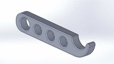

This works totally cool. I had been using a wooden popsicle stick to open my fuel cap. $1.50 + $1 shipping from rvplasticparts.com
Thanks for the review Jim .... that opener is on my short list of goodies to buy. Glad to hear it works well.

If you need anything more than your finger to flip up the tab on your fuel cap, then your cap nut is adjusted too tight and you will end up breaking the hinge pin.
Properly adjust and lube the O ring, and no tools needed to pry up the tab. The cone of the cap must be able to slide and drop as the O ring decreases in diameter so it can fit through the neck of the tank.

The force needed is very low and consistent with the right lube and adjustment. Although a fingernail works for me, the tool is easier and need not be very strong.
I have used Krytox for nearly a year now. My caps still open and close with a light touch and smooth as butter. No need to wiggle for the opening.
According to the number of posts I think that quite a number of pilots use a tool to open the fuel cap. So do I. I figured that it is quite difficult to adjust the nut in a way that it allows for opening by finger nail and still have the cap. fully secured in the filler neck when the lid is down.
On my plane it is an either or question. If somebody has a good way how to adjust I d'be happy to read from.

Here you go...... http://www.vansairforce.com/community/showpost.php?p=1377409&postcount=9
Thanks a lot. I will re-adjust the cap. accordingly. Changing the O-Ring in an annual basis seems a bit overkill. I apply on-cond. maintenenance here.
