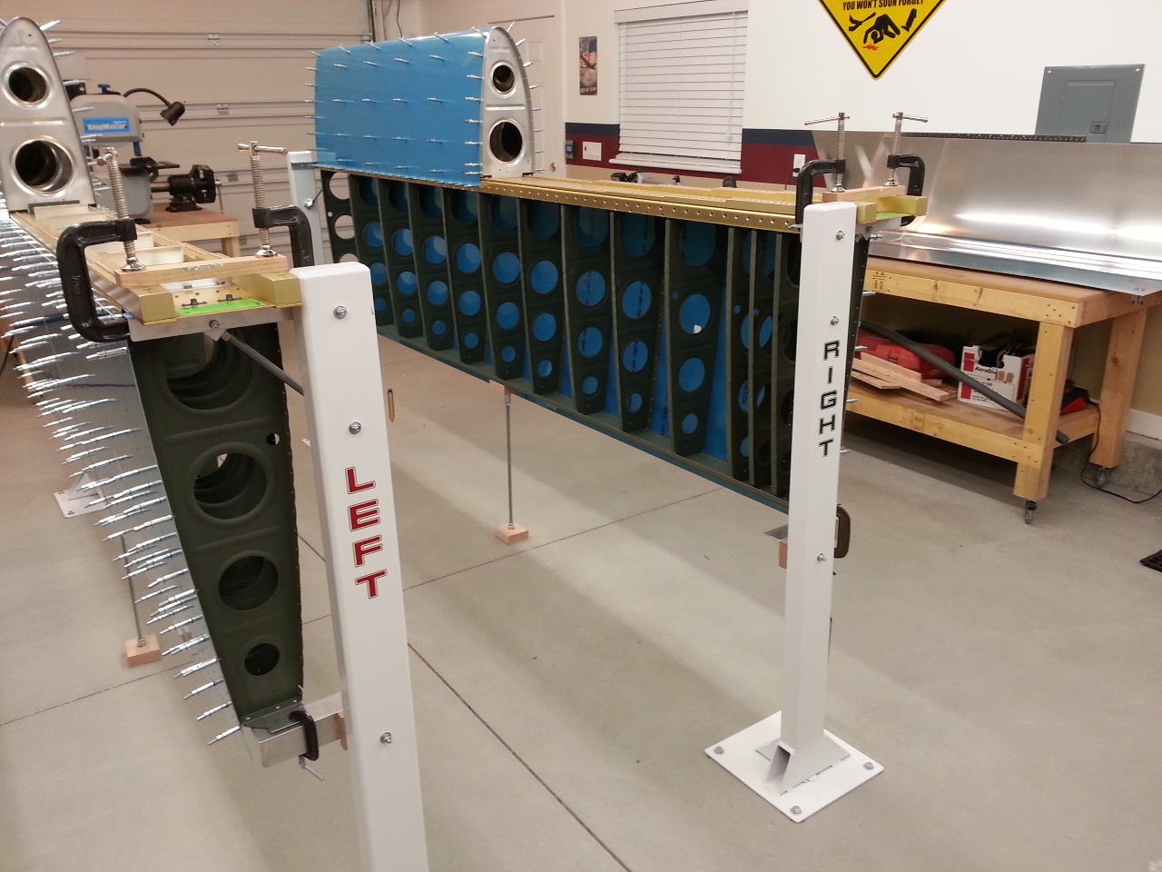

Just wondering if anyone has built a free standing wing jig. The ceiling in my workspace is very high, making it challenging to do a floor to ceiling post per the plans suggestions. And I am guessing (hoping even) that I am not the first to be in this boat?

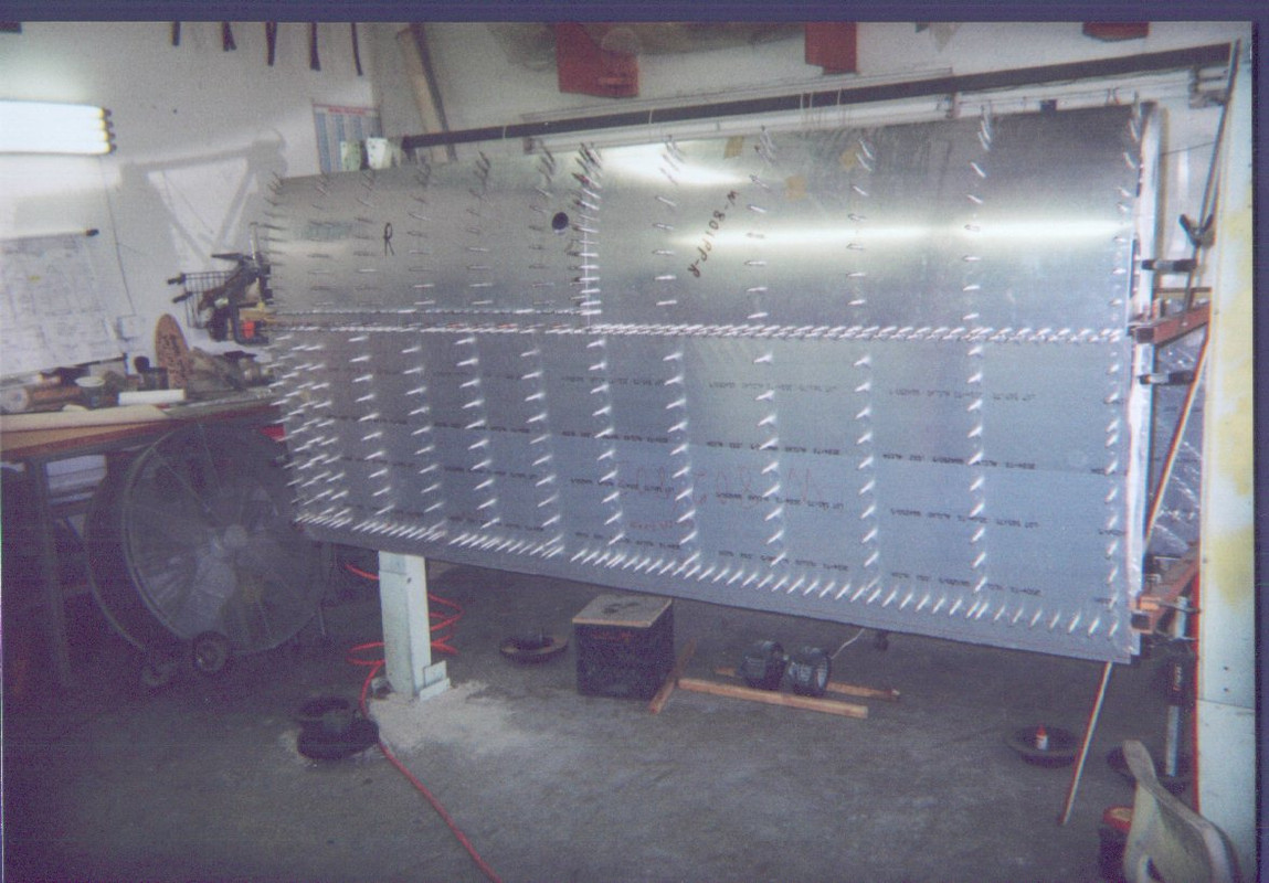

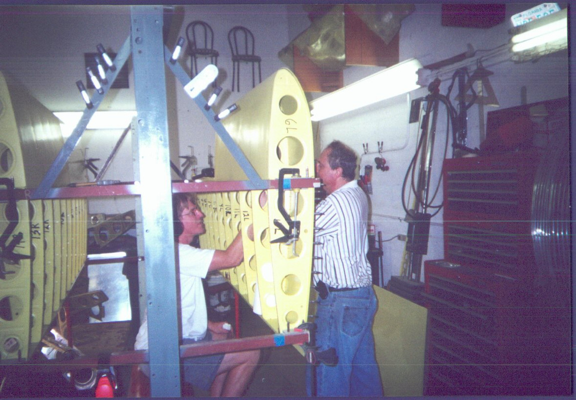

This is what I did and it was very sturdy. The diagonal brace on top kept everything in position. The 6x6 posts were anchored to the floor.

I made up a free-standing frame to support both wings at once, with enough space between them to work easily. Built it in place on the workshop floor to make sure everything was square.
I supported the spars outside the frame, on steel angle outriggers with adjustable supports. Similar but smaller supports lower down to adjust the rear spar positions and angles.
I also used the central wooden outriggers on the floor to attach threaded rods supporting the rear spars near their mid points.
All worked well, as long as I remembered not to trip over the cross-members on the floor.

Question, roughly high high above ground have you located the shelf that the spar rests on?
The one for my RV-3B is HERE and drawings for it are HERE.
I wanted at least 3 feet all around the wings and the same between them. More is a little better. It definitely helped to have them together like that.
I put a big R and a big L on each wing, on the blue vinyl, just as a reminder. That didn't hurt one bit.
