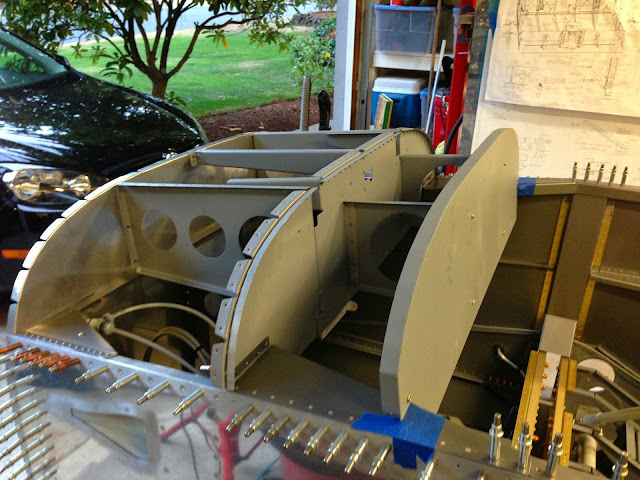

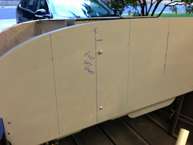

I am going to install Dynon Skyview in my RV-7 tip-up at some point in the future. I printed the Dynon images of a 10" and 7" screens to determine which screen I will use and its placement on the panel. It seems the left forward fuselage rib that runs from the firewall, through the sub-panel to the instrument panel is right in the way of the monitor placement. This means I will have to modify / move that rib.
I am just starting the canopy frame and the sub-panel is clecoed in place, so now is a good time to make the modification while I can easily take the sub-panel apart.
I have seen many RV-7s with 10" screens so folks have been down this road before me. If you have done this modification I would really appreciate seeing some images of your work. This is not an issue for aircraft with sliders due to the difference in the forward fuselage rib.
Thanks in advance.

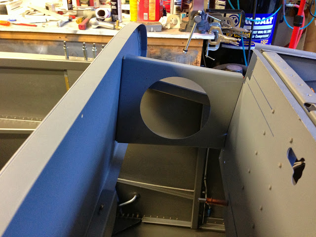

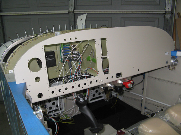

Hope these pics help ya Scott. PM if you have any questions.
Just cut them off like this.
Then move them inward as needed. I think I moved mine in about 5" on each side.
I have just the one 10" display on the panel, but room for expansion on the other side if/when budget and desire/need come into play later.
Just note that the subpanel is not flat. There is a bit of a backward bend on the subpanel. When you make the angle pieces to tie into the subpanel for the panel ribs that are cut off, you need to make them follow the bend.

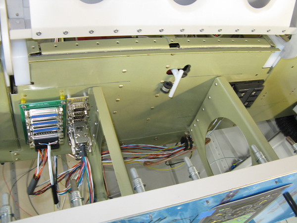

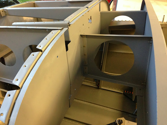

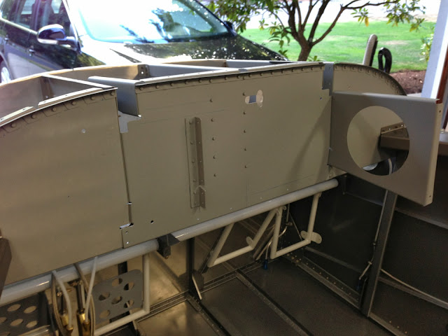

Another Option

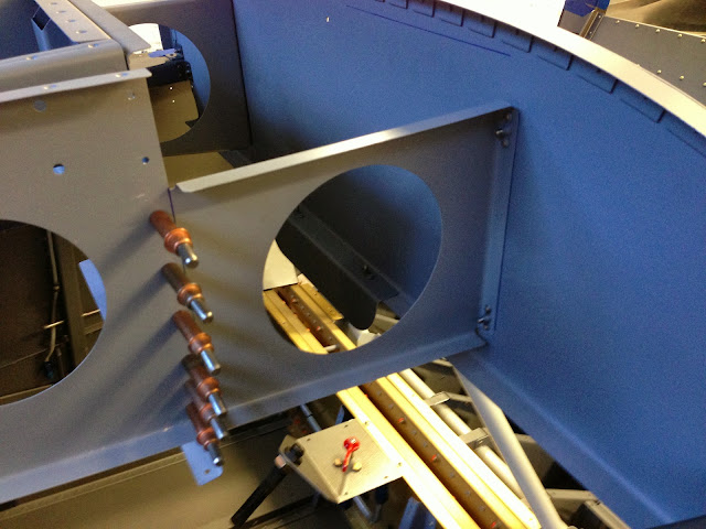

I did not want to lose the stiffness of the sub-panel with these ribs missing. The instrument panel provides additional support through the ribs.
I took this approach and with the end boxed in and a very stiff adapter to the panel, it became very rigid.
I can not help my self, my engineering training in structures would not allow me to change this design.:(

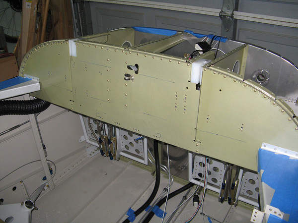

With the EFIS screens coming with Dolby nowadays, they are probably too big to do what I did with the early GRT units.

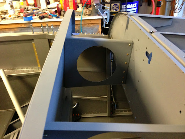

Here's my solution. Tip-up. Wanted to maintain the stiffness/support at the hinge bracket after talkin' to Van about it at SnF.
Plain ol' stereo, non-dolby
