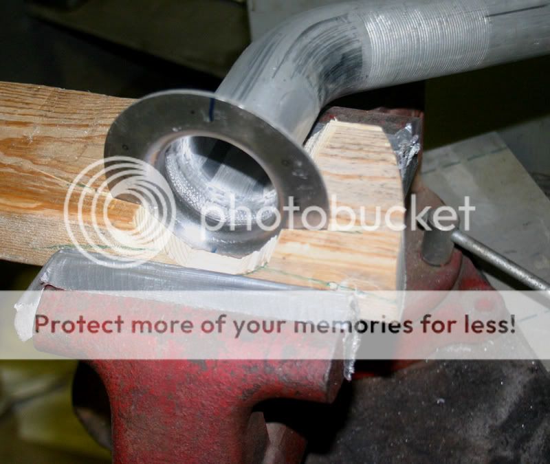

The fuel filler neck flange has to be bent to match the compound curve of the inside of the turtle neck skin. How is this best done??

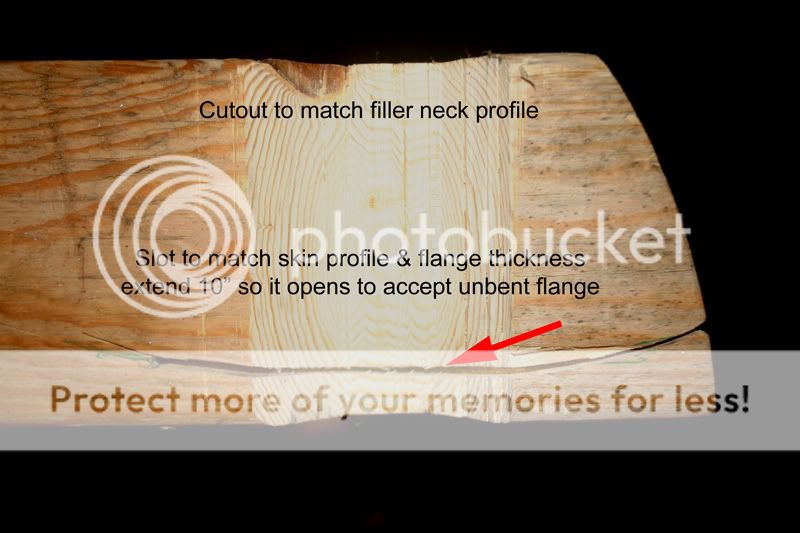

I used a wood mold
I traced the profile of the turtle deck skin, and then traced it on a board, and cut it out with a bandsaw, with 2 cuts to get the flange width.
I cut the fuel neck profile in the other dimension. I had already prebent the top and bottom lip, but I wanted the side profile better.
I put it in a big vice and squeezed it hard. It worked!

My flange is perfectly flat.....Has not been pre-bent at all. If I filled the gap with fuel tank sealant, it would be rather large.
Thanks to all for the replies. My flange was not pre-bent (guess that is the risk of a very early finish kit). Was able to add all of the curves such that I have less than a 1/32" all the way around.
