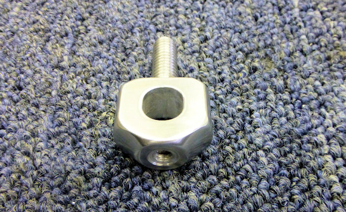

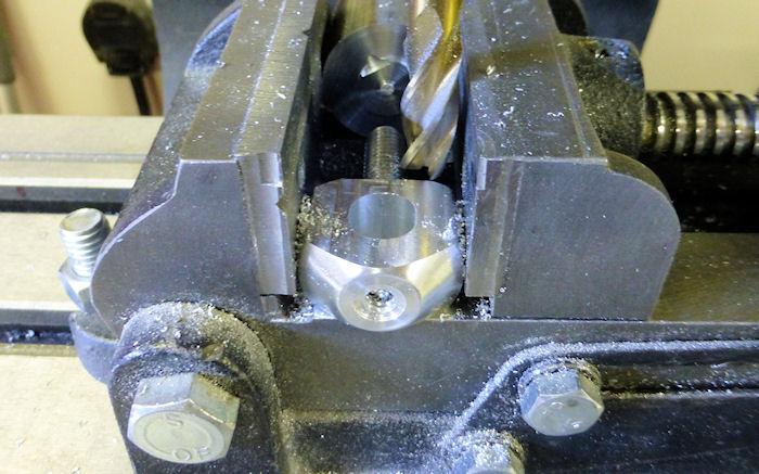

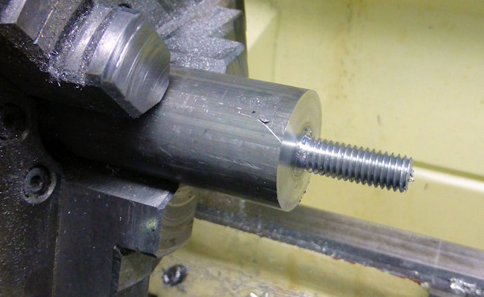

Aluminum Tie Down Rings
I will fly with my tie down rings
http://joesrv12.com/Builder Log/al_20_01.htm
Joe Dallas
Nice!
Those are nice. Be sure to use a lubricant on the threads as aluminum/aluminum tends to gall pretty easily...
So no concern regarding the strength of those using aluminum? Shear strength if side loaded when tied down in a heavy wind? And there is a gap between the bottom of my threaded tie down extrusion and the bottom surface of my wing skin. Do you have a sleeve spacer around the top of the bolt?
Very very nice Joe. Much better look than those cheesy steel loops I got Lowe’s aviation supply. So...what would a fellow -12 builder have to spend to obtain 3 of ‘em? If you just want to “rough them out” then I’ll do the finishing and polish.
The OP question

I have had request for custom parts and I will make them for other builders after I finish my aircraft.
I will add a page to my web site and list the parts and drawings of custom Items available.

Very very nice Joe. Much better look than those cheesy steel loops I got Lowe?s aviation supply. So...what would a fellow -12 builder have to spend to obtain 3 of ?em? If you just want to ?rough them out? then I?ll do the finishing and polish.
Radius
I see no radius at the base of the threads it should have one there and another thing is the sharp root of the threads will be a weak point. If you notice the tie down ring shown it has rolled threads with no sharp root. Also if one uses a thread lube such as copper coat on the threads will take care of things.
Joe, in post #21, you link to this photo:
If this is a sample of your tiedown rings, please, at least generously (as much as possible) round the edges of the rope hole. Rope has decreasing strength when the radius is small. In that sense it's a bit like aluminum.
Dave
Details not in first post
There is a 1/4" at the end of the thread that is .374" and the hole in Vans bracket is taped to 1.5" deep using a 3/8" 16 Pulley tap and then Counter bored to 3.75 inches about 5/16" deep for the tail cone and on the wings they have a two step shank 7/16" 3/8" deep and the .374"1/4"deep to allow them to be in contact with vans Brackets and not contact the wing skins
Also I have chamfered the hole, However I use S hooks at the end of my tie down ropes
OK?
So still no radius at the end of the threads and the threads are still sharp in the root. Every one on here worries about stress risers in scratches which are the same. Not putting down your design just saying that its a stress point when side loaded.

With the angle less than 60° and the bolt is in a counter bore I can't see the loads needed to shear the 3/8" 2024 T3 Aluminum with a shock load from a tie down rope.
Also my aircraft is in a hanger 90% of the time.
I feel comfortable with this design.
Joe Dallas
