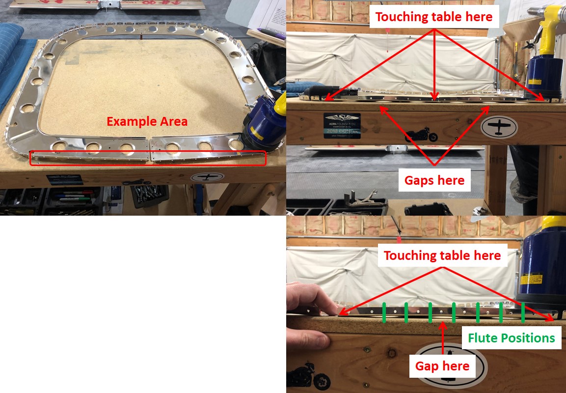

I just started the tail cone section on my -12 and hit a road block.
Step 4: Flute the F-1208-L & -R, F-1209-L & -R, and F-1210A-L & -R Fuselage Frames to align the flange holes. Flute the 'hump' of any humped flanges toward the web of
each fuselage frame.
Where do you flute to make the frame lay flat. Tried the outside flange and that made it worse. Tried one spot on the inside flange but I think its too short (may have even cracked, reaching out to Vans on that one). Would like to hear some input from others who have gone before.
Frank
An inside flange should technically never have to be fluted because the forming process is actually stretching the material to form the flange and fluting is essentially shrinking it.
As described in the plans, try checking the hole alignment on each flange segment with a straight edge and flute between the P. P. holes until the holes are aligned with each other. If you over do it slightly, lessen a flute by squeezing it back with some flat faced pliers padded with some tape.
I too was confused for a bit here. Because of the way the parts are sprung/warped/twisted it is not obvious where fluting will help until you try to force the part flat on a bench. In the example shown below you can see that when the bottom portion of the frames are forced flat there are two humps, one on the left half of the frame, one on the right. Fluting as shown will fix this. Repeat this process around the other sides of the frame. Doesn't have to be perfect as others have said since the frames are quite flexible.
