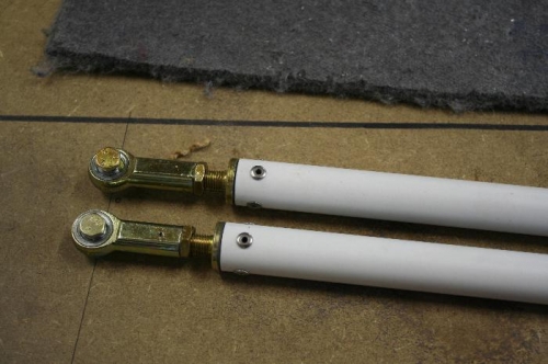

D Dunx Member Oct 15, 2018 #1 Plans page 32-06 specify MSP-42 Rivets , assume this is correct. As they are beveled do you countersink prior to riveting ? Thanks in anticipation

J John-G Well Known Member Oct 15, 2018 #2 Don't remember countersinking the push tubes for that rivet.
S sjhurlbut Well Known Member Oct 15, 2018 #3 rivets MSP-42 rivets should be doomed head steel rivets used to attach end to control rods. No countersinking.

Gagarin737 Well Known Member Oct 15, 2018 #4 MSP : Monel (rivet) / Steel (mandrel) / Protruding (head style) I think you we were about to use the wrong rivet
