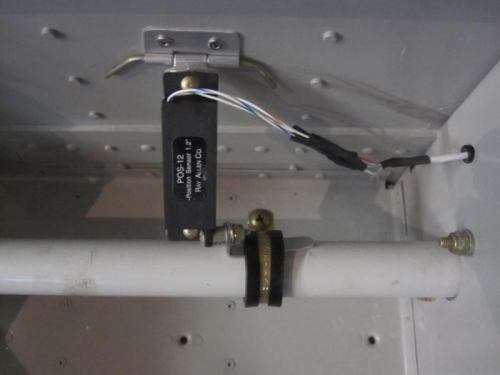

Another approach/location to mount the position sensor. I think it's a little easier to install than in the tunnel.
That's a nice set-up Bob. I used something very similar to Bill's. Not flying yet, but after a couple of set-up glitches it seems to be working perfectly on the ground with the FPS Reflex.
