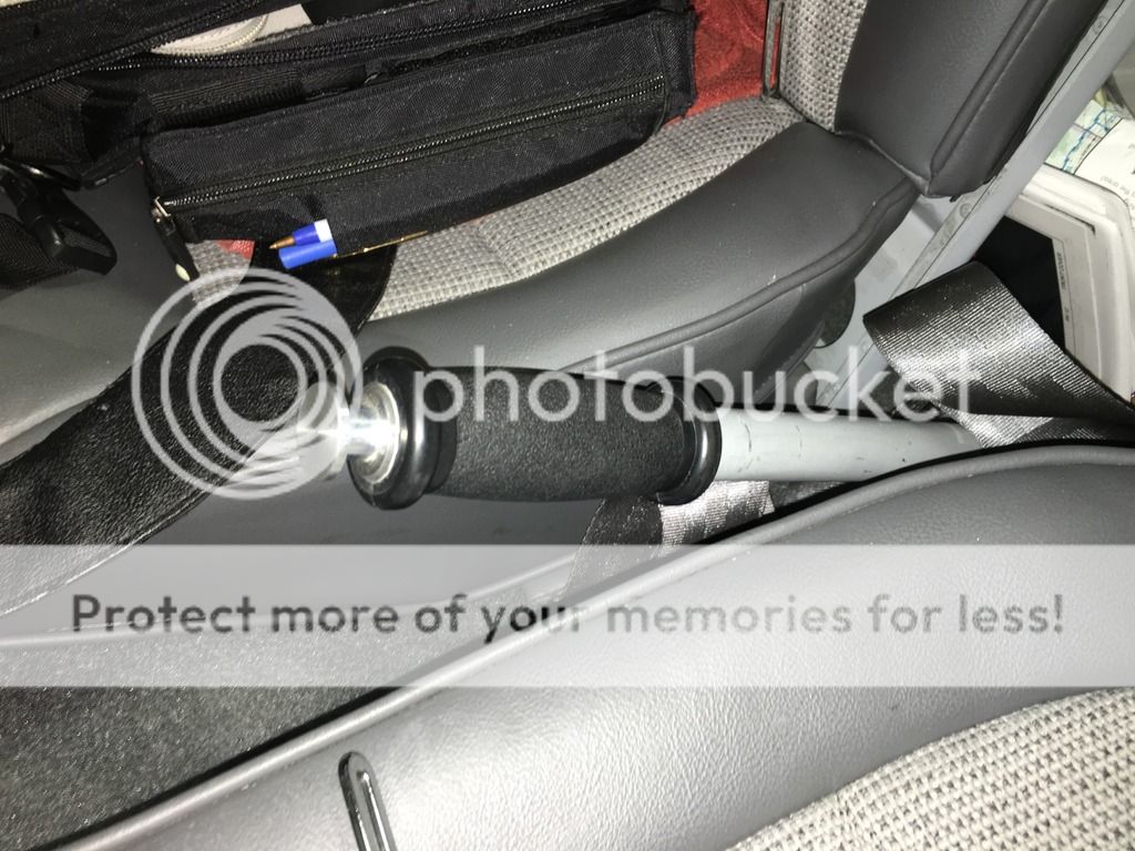

I've seen this issue brought up before, but it has never been a problem in my 12. I put a control stick grip on the flap handle that has a flange at the end. I guess it keeps my paws from getting into the gap on the button. I can send a pic if anyone wants one. I haven't had much luck posting pics.
Rich,
The flange on the control stick grip is definitely what keeps your thumb out of the "pinch" zone. And the grip looks good too. I've built RC helicopters before but never a full scale aircraft, so I can't tell from your photo how you added the grip to the flap handle. Did the grip just slide over the handle, so it could be done by anyone (without assembly experience or an LOA from Van's), or did you have to disassemble and then reassemble something?
Lon
Lon,
Originally this was a grip with a solid top that was supposed to slip over a control stick tube. It had a small hole in the top center for a PTT switch. I just ran a step drill down through the hole until I had a hole flush with the manufactured hole for the stick. Then with the help of a little liquid soap I slipped it on.
Rich
