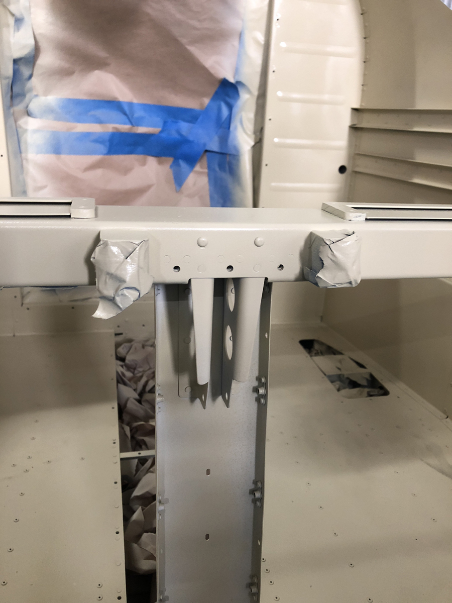

Here are a couple of photos showing the factory attach bracket.

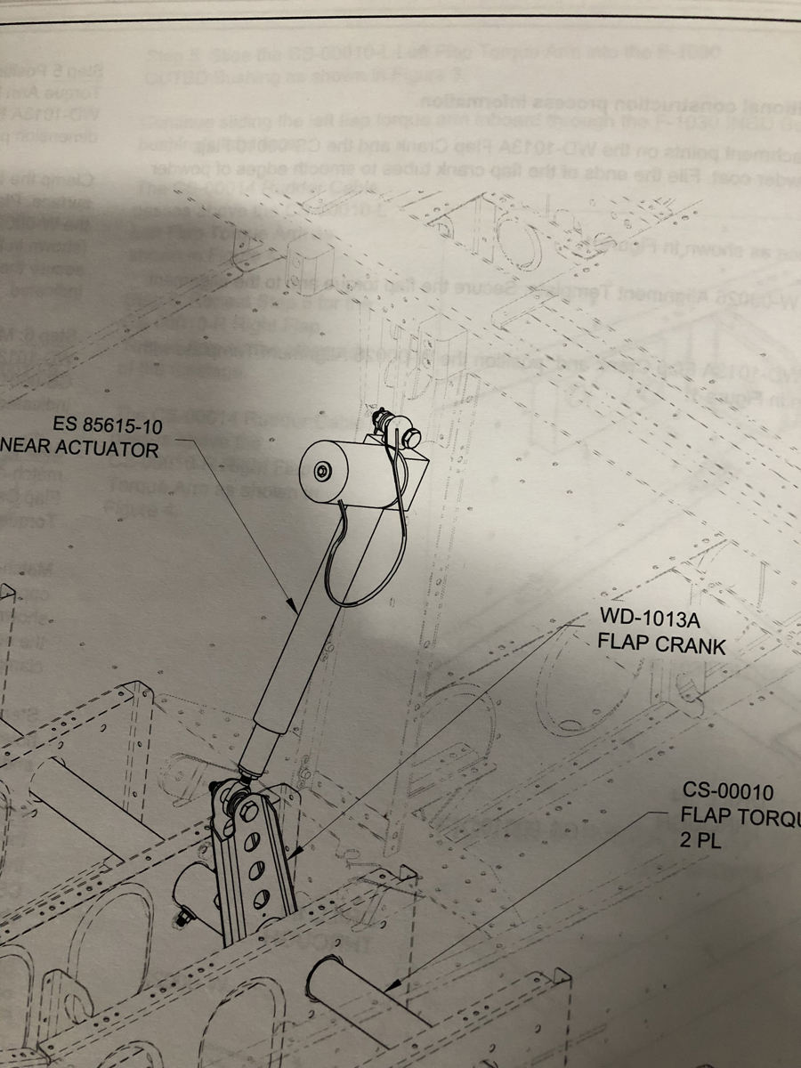

Hole-to-hole distance of the Vans RV-14 Actuator
We happen to have a stock RV-10/RV-14 flap motor that we use for testing. The hole-to-hole distance of the fully retracted flap motor is 10 1/4". That should help you calculate the position of the flap actuator arm (flap crank in the drawing above) fully retracted (flaps full down). Of course you should have some adjustment leeway in the flap linkage as well.
Thanks for your replies. I'll document what I end up doing. The new flap actuator is at the post office so I haven't had a chance to look at it in context yet. The RV-14 flap motor brackets have lightening holes that eat up nearly the entire web, one of which is almost perfectly centered on the 1.5" mark from the stock flap motor attach point. So, if I use the stock brackets, I will have to add material. I hesitate to throw the stock brackets out, because they are perfectly engineered to fit and rivet on both fore and aft flanges, a level of structural integrity which I probably can't duplicate. I'll have to see if there is room to bolt a bracket onto the stock brackets to keep them in the loop.
Update: I clecoed the flap motor channel and brackets into place in the fuselage and measured. The gap between the brackets is 0.623" while the width of the end of the PH flap motor is 0.783". So the stock brackets definitely won't fit the PH flap motor, regardless of length. It looks like I will have to engineer and fabricate a mount for the PH flap motor from scratch. Now I won't feel so bad calling my plane an "experimental," since there are actual experiments involved. :)

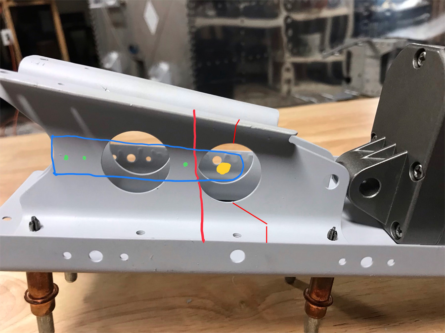

I've been pondering the possibilities still. I took a couple pictures tonight and that has helped me brainstorm a bit. I'm posting my thoughts here in the hope I'll get some constructive criticism.
If you look at the top view of the PH actuator up against the stock bracket, you can see that the outside edges of the stock bracket are almost perfectly lined up with the actuator. If you look at the side view, it is about 1-1/2" from the stock mounting hole to the center of the lower (right in the photo) lightening hole. That is the difference in length between the PH actuator and the stock one.
Here's my current plan A:
1. Cut the stock brackets at the red line. This will leave both front-side (top left in the picture) rivets and two of the four back-side (bottom row in the picture) rivets intact. I will lose the two lower back-side rivets.
2. Cut some aluminum, probably from a piece of angle, roughly in the shape of the blue outline. One piece on each side.
3. Rivet the new pieces on the outside of the stock brackets, using the rivet locations shown in green. I will probably put thin shim pieces between the stock brackets and the new brackets in order to ensure there is sufficient room for the flap actuator, which is just a hair (0.021") wider than the outside edges of the stock brackets.
4. Mount the PH flap actuator at the position marked in yellow.

Ari, I like your solution so far a lot. For the angle extensions I would suggest at least a 1" angle, perhaps 1 1/2", by 0.063", so you will have plenty of edge distance for the required 5/16" hole to attach the actuator. I don't think you can cut the existing bracket from the other end because that attaches to the crossover structure above the seat post as seen in the earlier photos. Looking good.

What I would do is dimple and set rivets in them. You could also fill the holes with micro and sand them flush.

Ari, here's a suggestion for trimming the bracket. It also utilizes a couple more of the existing rivet holes.

I like your suggested cut, which should still allow plenty of room for the small angle of pivoting that the flap actuator will need. I have one of the bracket pieces in my kitchen now so I'll remember to do some tracing, measuring, and drafting for the new brackets. That's one of my weekend projects, in between priming other pieces.
I'm thinking of using aluminum bar stock for the brackets. I will use some scrap aluminum sheet from my empennage kit to make shims that are about 1-1/2 inches wide and 2-1/2 inches long. Then I will use bar stock 1-1/2 inches wide and 3 inches long for the brackets. I drew this out and have more exact measurements written down, of course. A cut on the factory brackets based on Pat's drawing in this thread will let me use 4 rivets to secure the new brackets and shims to the factory brackets. This should be more than stable and strong enough for the flap actuator.

I ended up, with Pat's help, coming up with a good solution for the PH Aviation flap motor in an RV-14. I put together instructions with pictures in a PDF that I sent to Pat so future customers should get that with their order. If anyone wants it, you can send me a private message with your e-mail address. The end result is a pretty easy process.
