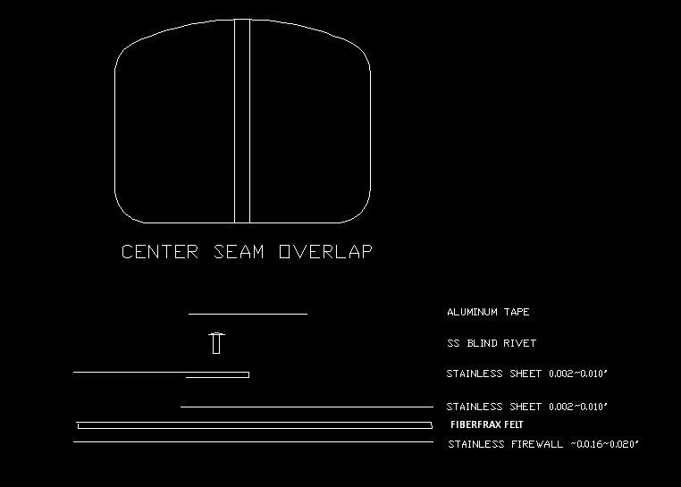

There are fancy ways to do everything, but the best bang for the buck continues to be ordinary fiberfrax under stainless foil. Do the overlap seam in the middle with the aluminum tape. It's a vent...which, BTW, would be even more necessary with the alumina trihydrate.

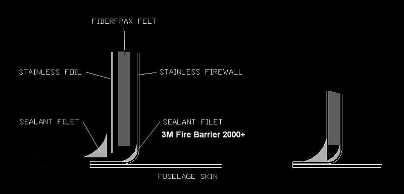

Start by making sure the perimeter of the firewall is sealed gas tight, using a light wipe of 3M Firebarrier 2000 silicone.
The fiberfrax and foil are attached using SS pop rivets and small stainless washers. No glue required, but if you prefer to use a few dabs of Firebarrier to tack the fiberfrax to the firewall, no problem. Tape it up there until the Firebarrier cures. The tape can stay if aluminum.
When the foil are fiberfrax are riveted, apply a filet of Firebarrier over the foil edges at the firewall perimeter, and at any openings. Definitely bury the edges of the foil, both for sealing, and for your own safety. SS foil cuts like a razor.

Note the lap seam down the center, sealed with aluminum tape. In the event of a serious fire, the tape melts and provides a vent for outgassing of the organic binder in the fiberfrax.
