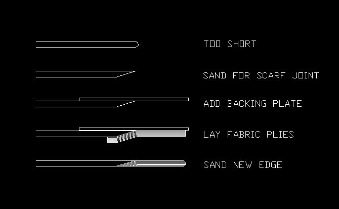

![Scarf%20Extension.jpg](/community/proxy.php?image=https%3A%2F%2Fwww.danhorton.net%2FVAF%2FExtending%2520a%2520Cowl%2520Edge%2FScarf%2520Extension.jpg&hash=4e720c55d4a422fa21015420ad054061)
I'm extending the edge of my cowling using the method Dan Horton posted.
Question
- When laying up multiple layers, do I have to wait for each layer to get tacky before applying the next layer or can I apply multiple layers at once?
- Can I stack all 5 layers on a plastic sheet, apply epoxy, cover with another sheet and squeegee, then apply all 5 layers at once.
I have a small area to do and it seems like a big waste of epoxy to mix up 5 or 6 batches of epoxy for the 5 or 6 individual layers.
