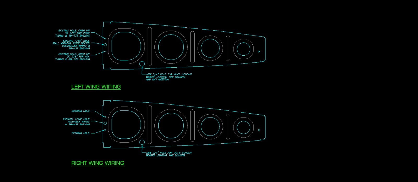

Hi Folks, just hoping for some feedback before I start drilling holes in the ribs for my wing wiring. Just a quick idea of what I intend for the plane. VFR/IFR Capable, Dynon Avionics (Skyview) and AeroLEDs - Aerosun VX and Pulsar Lighting.
Left Wing - Dynon Heated AOA Pitot, Vans stall warning (As a backup), Pitot heat controller, Wingtip NAV Antenna and lighting as above.
Right Wing - Dynon autopilot servo and lighting as above.
Any input to things I may be have missed would sure be appreciated. :)
You might want a magnetometer out on the end of a wing. As well you might want OAT probe(s) somewhere on the wing (ie inspection panel).

If you go with the plumbing at the location planned, give some thought to how the plumbing will pass the bellcrank. I ran mine through but had to fab a bracket to hold the plumbing lines and keep them away from the bellcrank. Photos are on the "wing" page of my blog. I drew it up. If you want a copy of the drawing, send me an e-mail.
Also, once you decide, drill one with small pilot holes. Clamp an opposite rib to it and match drill. Use these two as masters to clamp and drill the others then enlarge all the holes to final dimension.

Thanks Mark...Exactly the kind of input I was hoping for. Now I have a bunch of reading to do on Magnetometer locations :)
I made a spreadsheet with all of the rib holes and which wires/tube runs where. It is very helpful to keep track of everything. I started using my spreadsheet when I was drilling the rib holes. I have an arrangement like you are proposing. Some holes are not needed in all of the ribs. For example the pitot is in the middle of the wing so those holes don't need to be placed in the outer ribs.
In my case there are lots of wires. OAT was mentioned. I have a couple of those. Stall warner if you are going to put it in is also missing from your drawing. Some people put a nav antenna in the wingtip so a coax would be reqired. Heated pitot power and status wires if you want one of those.

On the tip rib, on my RV-3B, the tooling holes are used to line up the ailerons. On the RV-7, that's shown on drawing 12A. I'd recommend keeping the area near those clear.
Also, as other people have suggested, figure out how you'll carry the various things past the aileron bell crank.

This is an important tip. Don't enlarge the outboard end rib alignment holes. You can drill them later.
Sounds like my setup is exactly the same as yours. I ran the wires for my pitot heat in the 3/4" main conduit at the bottom of the rib. I did the same with the Dynon Roll servo. I just cut a slot in the black plastic conduit and fed it in from the heater and servo. Looks like I've got my components on the same wings as your planning. The aileron pushrod passes through the forward lightening hole and in my opinion, I'd rather have everything routed as not to get in the way of it. It's a tight area between the root rib and the fuselage so by routing all the wiring thru the 3/4" hole, I can go straight into the fuselage and do a better job of staying out of the way of the aileron push tube. I'd rather turn the corner with the wires inside of the fuselage where it is easier and more accessible to inspect than at the root rib. I put a service loop in my wiring out at the tip rib for the AeroLED NAV/Strobe and AeroSun landing/Taxi Lights. I put another service loop at the Dynon pitot heat controller which I mounted to the inspection plate. I work with computer networks and I am a firm believer in using home runs on the wires and not adding connectors at the root rib, etc. It's not my intention to ever remove the wings now that they're on but if I ever need to, I can cut the wires at the root rib and use the service loops to aid in installing electrical connectors if ever needed. My temperature probe is mounted under the HS for shade from the hot New Mexico sun while sitting outside somewhere.
I'm a fair weather flyer and have gone straight Dynon on everything ( No finger pointing between avionics vendors if something doesn't work right). All antenna's are on the fuselage so I have no need to route coax in the wings. I try to follow the KISS principle with a close second of keeping everything as easy to access and service as possible. I think "easy access" may be an oxymoron when used in the same sentence with the word "airplane".

Ok, Great advice and tons of food for thought. Really tough to find information on where to mount the remote magnetometer from Dynon as it is so new.
Drone Pilot...Excellent advice on running the roll servo and pitot heat from the 3/4" conduit. Didn't even think of that! It would take the wiring out of the 7/16" holes and free them up for potential NAV/Comm wiring. I am a bit nervous about adding extra holes beyond those described on Van's PDF on wing wiring hole recommendations, and this will help avoid that.
