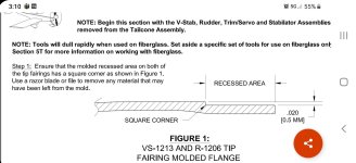

Can you post a picture? I'm about to install the same fairings. I know step 1 says to square the corner with a razor or file. The print shows a perfect 90 degree corner. Are most of you guys taking the time to do this? If so any tips or tricks to accomplish it?
stabilator fairings.

Thanks for the pic, not perfect but looks fine to me. I've been putting off installing these fairings for months while waiting for my wings worried about not getting them perfect. But I'm going to just do my best and move forward. As they say we aren't building a swiss watch.
