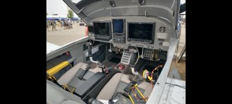

Flightchops has all 3 levers on his quadrant. This pic is from 2021 at Oshkosh but his recent YouTube videos show all of them there still.
Right. Well it looks like I got that very wrong then.
Thanks for pointing that out.
