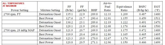

An airframer might specify excess fuel flow because the cowl and baffling is poor, but the Lycoming's "minimum fuel flow for rated power" charts are clear...roughly 0.48~0.52 BSFC. Simply divide estimated horsepower (at the altitude of interest) by 2 for a reasonable estimate of fuel flow in lbs per hour at 0.5 BSFC In the field, full rich at 0.55 BSFC is plenty.
I guess I will have to order another Ballenger unit and slap it on a C172 or something. After filing all the appropriate paperwork and receiving proper approval from the FAA......
Or just use EGT. Best power is about 100 ROP, example below.
I've also attached a data table taken with all temperatures at maximum. Note BSFC's at max power and detonation onset. This kind of data determines the "minimum fuel flow for rated power" values.

I am working on cooling it wit hair to get the Oil temps down so I can run closer to best power in climb as well as in cruise. But you are right, I did choose a cowl design that doesn't cool well and built an engine that makes too much heat when fueled properly. And it's not that fast, honestly I think I'm missing about 20 knots somewhere. Using .5 BSFC 17 GPH puts me right about the HP I should be making. I need to check the wideband calibration, 17 should not be that rich. I guess I can cross check it against the EGT next flight too. According to your chart 100 ROP should be around 12.5:1 AFR.
Don't forget about the effect of altitude and temperature. Reputable engine vendors report corrected HP...the theoretical power it would make given sea level, standard day conditions. For example, if your engine pulled 200 corrected HP on a calibrated dyno, actual HP is roughly 183 at 75F and 2000 ft. A nice safe BFSC of 0.55 would be 15.25 GPH, and that drops continually in climb.

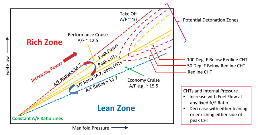

yes, Density altitude on the last flight was 835 feet. That would make takeoff fuel flow a tad bit higher than full rated HP. However the plot thickens. I came across this chart from kitplane magazine suggesting that takeoff AFR is/should be/might be/? 10:1.
I wasn't proposing to cross check the AFR with EGT and takeoff power, I am aware that would be a poor decision. AFR should always be around Stoich at peak EGT regardless of what the power setting is. I will do that at 6-7K feet. I don't necessarily like A/F meters, One was supplied with my SDS kit and I installed it. It proved to be very short lived, went through sensors sometimes in single flights. I gave up on it for a while since the engine was running relatively well, then installed the Ballenger unit. It has been going strong since installation. It uses a different (more expensive) sensor. When the original sensors failed, it was evident, they weren't just wrong they were inop. Perhaps this one drifts. I think it has a free air self calibrate, I will read up on that.

Kitplanes editor says the AFR diagram was from George Braly (GAMI), so it is from the right people.
Yes, it's obviously a re-drawn "Red Box".
I did some checking, and 10 F/A is about right for full rich. I can even find some turbocharged stuff closer to 9. However, they won't make rated power at that figure.
