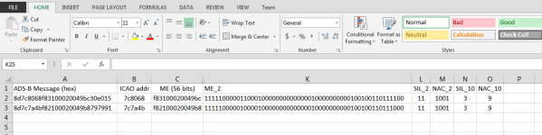

Soon I will be installing ADS-B out equipment (Dynon transponder and GPS source) in my RV-6A and need to run a ground test after installation. The nearest avionics shop with a ramp test unit is 250 miles away so I've been looking for a way to run the functional test locally at my farm hangar.
I'm planning to use a Software Defined Radio receiver (SDR) similar to those used to feed flightradar24, flightaware etc to receive and decode the ADS-B signals from the transponder.
So far I've purchased and installed the USB receiver and antenna (cost under $30 USD) and can receive and display local air traffic ADS-B data using the open source ADS-B decoder "dump1090". This decoder can display most of the required data for the test but there is also additional system performance info required e.g. SIL, NAC. I'm using Excel to decode that info from the raw data.
Screen shots attached. If there is interest then I'll post an update once the transponder is installed and ground tests have been run to prove that this process will work.

Hi Paul,
This is a great idea and I'd definitely like to know more when you have some info to share. Are you using dump1090 as-is to get the data you're decoding in Excel, or did you modify it?

Hi Dave,
I'm using Dump1090 "as-is" (the Malcolm Robb fork or version from Github) with Windows 7.
The --debug switch outputs data that can be directed to a text file.
From there it's a manual process to find a type 31 (operational status) extended squitter message and copy the encoded message string to Excel for further decoding.
It would be more elegant to enhance Dump1090 to decode the relevant message types but I'm doing this as a one off "quick and dirty" to check my transponder!
PDF of the debug log file attached for interest.

Test completed
This is just to provide an update on the outcome of the experiment; it was successful and I was able to validate that the ADS-B transponder is functioning correctly on the ground. (The aim was to conduct a ground test of a new ADS-B out Trig transponder installation to verify that it is sending out the correct data.)
The test receiver is a Software Defined Radio "SDR" USB device. There are many options on eBay but the nooelec brand has a good reputation and solid support. I bought the NESDR Mini on Amazon AU for about $45 (USD $27) including antenna and shipping.
https://www.nooelec.com/store/sdr/sdr-receivers/nesdr-mini.html
This device plugs into the USB port on a Windows PC, or a tablet, or Raspberry Pi computer.
On Windows I used DUMP1090 open source software initially to decode the ADS-B signal and display the traffic. This version worked well:
https://github.com/MalcolmRobb/dump1090
The SDR receiver and small antenna can pick up commercial traffic several hundred miles away, these signals were received through my study window.
A more complete decoder and reporter is available free from a developer in the UK:
https://getyourwings.co.uk/uncertif...st-checking-the-output-from-your-transponder/
The report that it generates includes lat, long, aircraft ID, ICAO code and the internal system indicators to validate the ADS-B out installation e.g. SIL, SDA values etc.
As a bonus, the SDR receiver when plugged into the USB port on the tablet that has Avare ADSB installed (free version on Google Play Store) and enabled for GDL90 will display direct-received traffic on Ozrunways EFB, along with other traffic that comes in via the mobile network. This provides a low cost way to display ADS-B in traffic.
There was a bit of setup work to get the receiver working initially but it was fairly straightforward and problem-free and very good "bang for the buck" and was quite interesting for the learning.
The GPS receiver was unable to receive a strong signal in the shop and I shifted the airframe to get a clear view of the sky out of the door. I also tested for interference on the radio while the transponder was functioning and there was initially some crackle due to the use of RG58 cable. I replaced this with RG400 and that resolved the interference.
