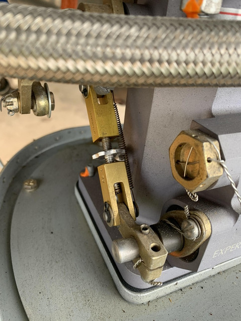

Then I checked the idle mixture. The RPMs rise was 30/40 instead of 50. When leaning, the RPMs went to 1.030/1.040 before dropping.
I enriched slighlty turning less than a turn (three "notches"). The RPMs rose to 1.050/1.060. I came back one notch (so 2 notches enriched) and obtained the 1.050 rise.
I didn't fly, yet. However, minimum on the ground is perfectly round (600 RPMs).

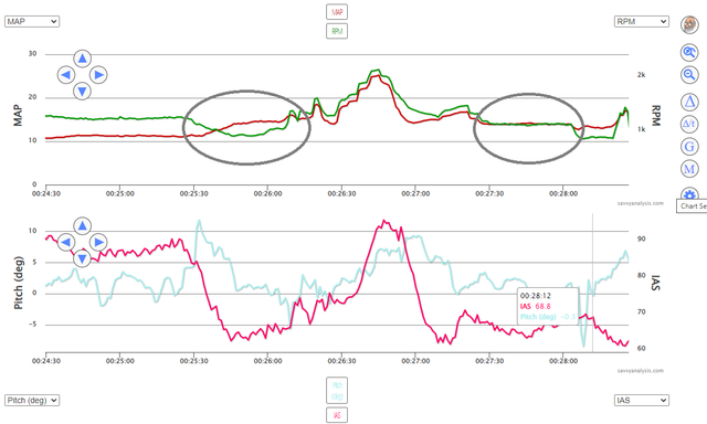

I downloaded the Dynon EMS logs and uploaded to savyaviation website.
This is the first flight when the issue occurred (2021_09_25_14.36Z):
https://apps.savvyaviation.com/my-flights/36732/9934c7c2-67a9-44c9-b175-4cc3d944dd25
Problem started a few seconds before minute 26.30.
At 24.03 engine was idled.
From 25.27 RPM dramatically went down (approx. slightly low 1.000 RPMs), even if MAP was left unchanged.
At 26.30, after the engine "hiccup", I gave power and made a 360° close to the runway.
At 28.30 I landed.
I noticed that just before the RPM drop pitch raised by 5° (from 5° to 10°). Maybe the airflow disturbed the idle...
This is the relevant part of this flight. Note that the first circled area is when the problem started and the second one is the final part of flight, where RPMs normalized. It is strange that for same MAP RPMs changes very much.

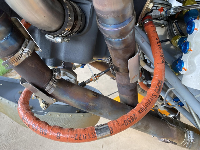

I installed 2 more shields on the exhaust, close to the fuel line.
I checked for the minimum idle setting and screwed clockwise two notches (it was only slightly leaned).

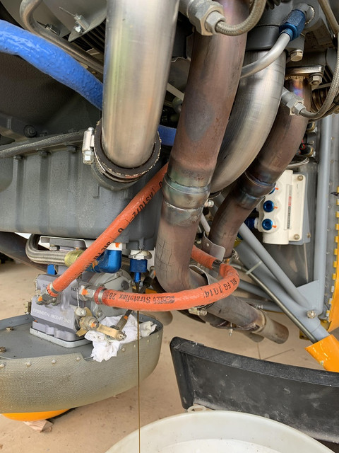

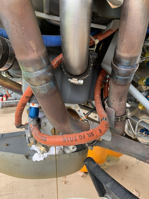

I’m no engine expert but your fuel line that attaches to the throttle body just above the throttle arm is VERY close to 2 exhaust pipes. Even though it’s fire sleeved I suspect that the fuel may be getting too hot and introducing some vapor. I might suggest rerouting that line up and over the intake tube to completely avoid the exhausts (or making a new fire sleeved fuel line to fit).
Just my two cents but you’ve ruled out the obvious intake leak and mixture.
I may be full of it and get flamed out in this forum but it wouldn't hurt and it’s certainly worth a try.

I agree with Oly - this looks like a vapor issue probably caused by the long runs of your fuel line near the hot exhaust. In fact, you've pretty much confirmed this since adding heat shielding to the exhaust pipes reduces the problem.
You can get hose of any size, shape, and clocking from suppliers like these guys: http://www.aircraftspecialty.com

It looks like you have the fuel line that runs between the servo and the spider manifold routed from the injector servo all the way to the rear of the engine on the cylinders 2/4 side where I’m assuming it runs up to and through the rear baffle then back forward to the spider. This is a very long and convoluted path that is likely doing you no favors in terms of heating the fuel, in addition to the issues noted by others.
Lycoming normally routes this line up between cylinders 1 and 3 through a grommeted hole in the inter-cylinder baffle, then nearly directly to the spider manifold. This is a much shorter and more direct route for this line that minimizes the areas where it runs near the exhaust system.

As Skylor argued, yes, my line goes from the spider back through the baffle and the fore, under cylinders #2 e #4. It is quite long. It comes close to the exhaust in one location, just before (or after) the outlet from the injector servo.
I will look if the different route through a hole between cylinders #1 and #3 will be suitable.
In the meantime, I rerouted the other hose. Now it comes close to exhaust in two locations instead of three and is way more far from the exhausts than before.
I must add that I also changed my flight behaviour, because I used to idle well before approaching the field, to let speed go down. Now, I reduce power at 1.500/1.700 and idle only when in final. I never experienced the issue again in the same way (even if I flyed just a few hours last year).
However, the engine still continues to miss some hit. I believe I should add a fuel bypass system to let the fuel return to the tank.

In post # 12, the line from the servo to the spider passes quite close to an exhaust pipe which does not appear to have a heat shield on it. This line could probably benefit from being rerouted also.
The fuel moves very slowly through these lines at idle, so each cc that passes has a lot more time to pick up heat. Also, at high power settings, the passing fuel actually cools the inside of the lines.

Also at idle that fuel is at very low pressure. At low pressure the fuel can boil in the line easier.

I have a new plane which I don't trust. I operate in a medium lenght strip (900 meters long) and during each landing I have to hope the engines doesn't betray me.
The day before yesterday, during landing at idle (short final) the engine missed some hit, from time to time. After taxing, beside the hangar, idled @ 650/700 RPM, after a while it quitted. Ok, I know: it was idled and medium temperature OAT (hot inside the cowl); however when engine is cold it maintains regularly the idle RPMs.
I will try to reroute and shield protect the fuel lines. However, for rerouting the fuel line from FF to the throttle body, I fear I can't pass behind, a la R14 on Van's site, unless I use some 90° elbow fitting. Otherwise the fuel line will make a sharp bend.
Ciao Camillo, a 90 degree elbow fitting is no problem on the high pressure side of the fuel pump. Avoid sharp bends on the low pressure side - between the pump and the fuel tanks.

Update: after a few more hours of flight, I can confirm that the problem is dued to high temperatures in the upper part of the cowl during the deceleration segment of the flight if/when idling. In that conditions the pistons are hot, the airflow slowers and if the engine is idle the fuel mixture runs very slowly, accumulating enough heat to vaporize. If in the same conditions I make an approach at 1.200 RPMs the engine runs OK.
After the engine has cooled a bit (i.e.: during the final phase or on the grond) idling is OK, too.
The problem arises only a while after idling and mainly during the last segment of the flight deceleration (from downwind to base leg), when the heat release to the divider and fuel lines is higher.
I'd like to see your Savvy plot showing EGT, CHT, RPM, MP, and Fuel Pressure - where the problem is felt.
The chart you posted shows RPM dropped... and thus MP increases.
But we need these other numbers to help understand why.

Other lessons... fuel picks up much more heat than you'd think, and the OP routing isn't good.
There's another recent thread where a fellow implemented a fuel purge/bypass to let some hot fuel circulate back to the tank and I was stunned how warm the fuel was, in flight, at around 70F ambient temp. Yes, he had fire sleeve too. Either fire sleeve isn't a very good insulator or a lot of heat is transferred from the mechanical fuel pump.
