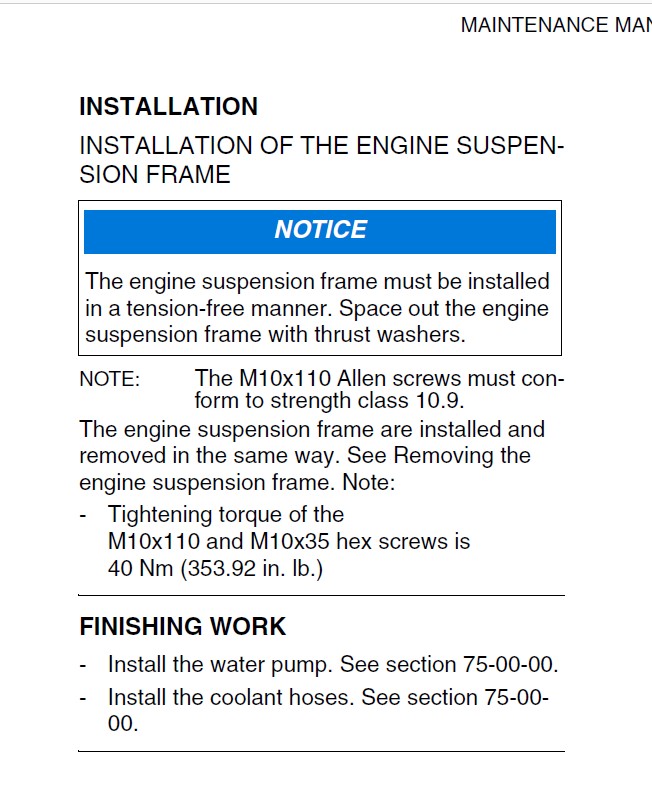

I'm doing my condition inspection and want to check the torque of the 4 allen head engine mounts. The KAI refers to Rotax IPC Sect. 28 Engine suspension Frame Assy. Torque Value, couldn't find section 28 of IPC, instead I looked at the Rotax Engine Installation guide, it said to refer to air frame instructions. Does anybody know what the torque is or where to find it? Thanks.
I don't have the ULS manual but the 912iS Heavy MM has a reference of 40Nm or 29.5 ft-lbs on page 24 of section 71-00-00 (July 01/2012).
Just checked the ULS Heavy manual. It's the same.
reference page 20, section 71-00-00 (Oct 01/2010)
I have torque stripe on two, the other two don't so I want to check it...thanks guys for your help!
It?s really not a big deal to do. You just have to unbolt and lift the intake manifolds to get to a couple of the bolts. Ten minutes max using an Allen head socket an extension and a universal joint or a good Wobble head on the Allen wrench head. I just finished my 8th annual and have never found one under torqued.
