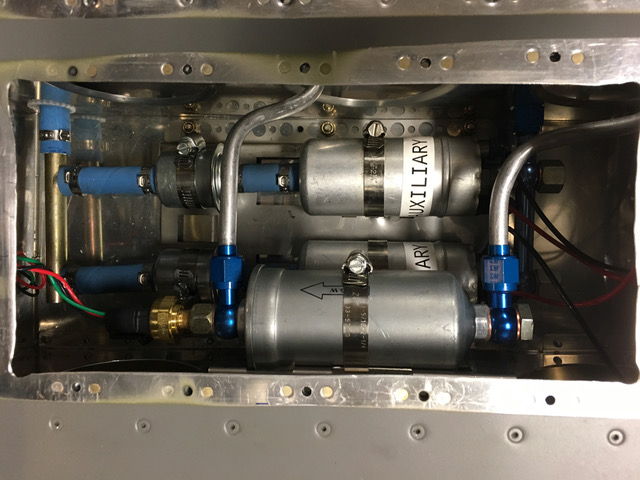

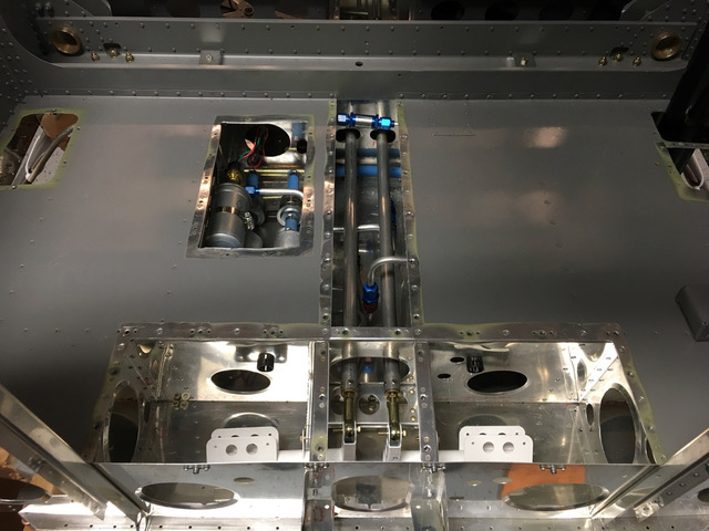

Standby Fuel Pump
At the risk of stating the obvious, including a standby fuel pump would seem to be a good thing.
Looking into the baggage compartment from behind
Fine fuel filter on top, but primary and standby fuel pumps below.
